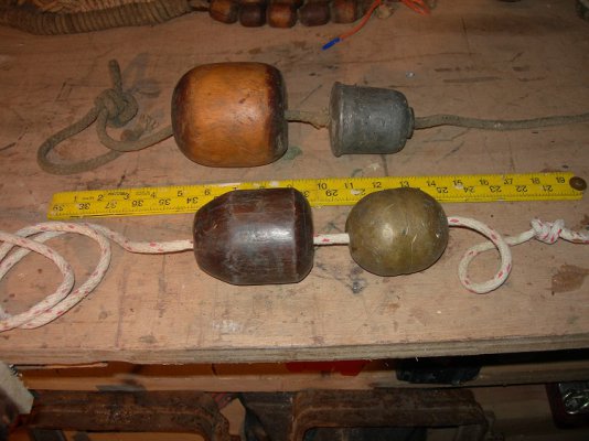

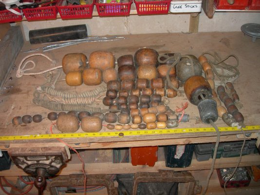

Yes Robgil, bobbins they are, in fact they are bobbins and snatch weights and they are used to return lead pipes to the correct diameter when pulling bends in them. I've done dozens of them in my time especially where fabricated bends (those made by cutting and welding) look out of place on period properties where they should match existing ones.
Briefly, if possible with me ( :roll: ) lead pipes are bent or thrown over the knee and after each pull, or throw, a dummy is used up inside the pipe to knock out the dent that forms against the knee. Using a bending stick or dresser the lead is worked back from the throat of the bend to the back of the pipe where it has thinned or stretched. After two or three throws the pipe is restored to its correct diameter by pulling the bobbin through the bend. This is achieved by the plumber at one end of the pipe snatching or tugging the rope, causing the snatch weight to bump the bobbin through. The plumbers mate is at the other end of the pipe and he pulls the rope so that the weight comes back so that the plumber can snatch it again until both bobbin and weight travel through the pipe making a nice round bend in it. There is more to do in the process but that sort of sums it up.

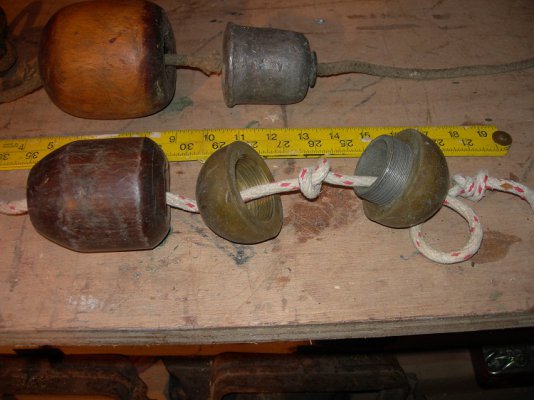

The snatch weight unscrews and the rope is knotted inside it so that it can be pulled, or snatched backwards and forwards.........

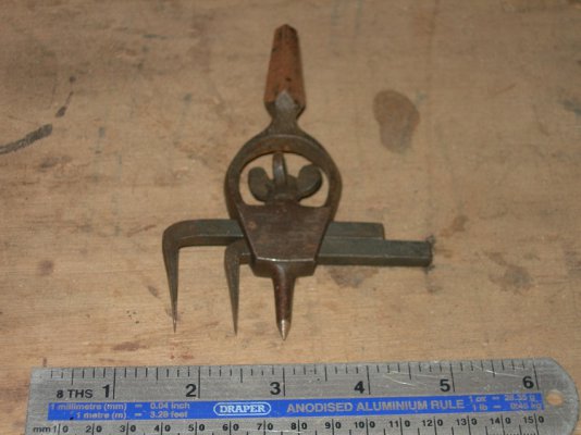

It's an adjustable travel trident, for the modern devil - so much more adaptable than those old-fashioned fixed tridents. Handy pocket size as well, ideal for the modern devil on his travels.
