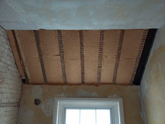

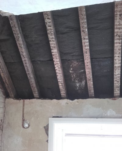

Heres a photo of the rafters exposed in one of my rooms after I removed the lath & plaster, and then a second photo of the job half way through when I'd insulated between the rafters ready for the PIR to go on top
Yes, its Steicoflex as opposed to the rigid Steico wood fibre boards so its a friction fit. You cut them slightly wider to provide the tension but not too wide, and obviously you need something to go over the top to keep them in place. I used PIR over the top, I could have used the wood fibre boards of course.How did you get the wood fibre boards to stay in place? Friction fit?
I have a stack of 80mm thick boards I bought ages ago that I need to find a job for. But they have a tendency to break up when forced into gaps.
