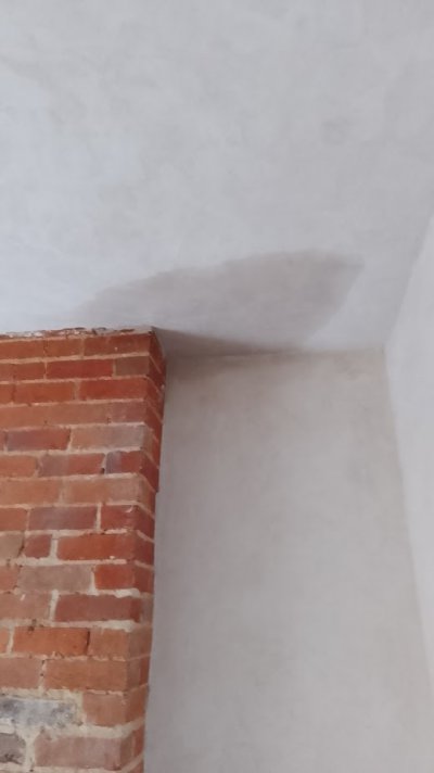

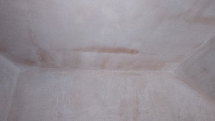

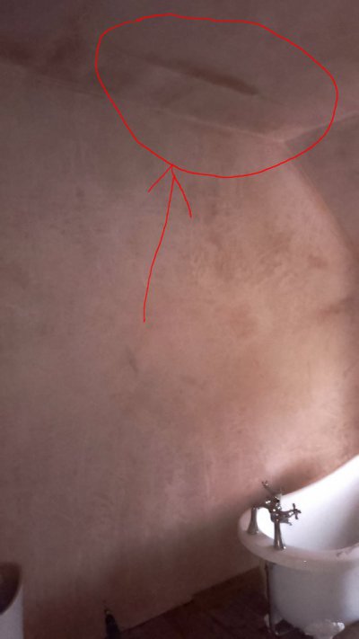

The junction between a roof and a chimney stack is always a notorious weak spot. My money would be on either flashing (if there is any - flaunching never works properly on the side of a stack in my experience - if it's flaunched I'd replace it with lead flashing) or pointing, or both. Possibly the flaunching around the pots, that gets a hard time.What with all the talk of condensation on here recently due to the recent dramatic change in outside temperatures I was at the house today and discovered this on my bedroom ceiling! Did we have some wild rain last night?!!
Anyways, I've always known there was an issue here, it gets damp in that corner periodically but its a bit of a mystery. I think its leeching from the bricks. Looks like I'll have to take another look. No point getting a roofer round though until Spring if mortar work is required.

Well, I had a look this morning and whilst there's always been an issue here since I bought the house (small damp patches) I wonder if that cold snap has escalated the issue. Quite a few of the timbers in that corner are now damp which has in turn leeched in to the adjoining lath & plaster ceiling. Its a bit of a dilemma, should I pay a roofer to take a look now and see if there's anything obviously amiss that can be fixed or temporarily fixed, or should I wait until spring and get some scaffolding erected for a full on assault. I'd rather not have any repointing done now in Winter and I know a roofer would just 'cement' it anyway, or any new flashing that may be required. I also know the flue on this side has a hole at the top so a pot or pots will be required with some proper flaunching. Question is how long do I leave those timbers to be damp, unless it was a freak occurrence due to windy conditions and rain.The junction between a roof and a chimney stack is always a notorious weak spot. My money would be on either flashing (if there is any - flaunching never works properly on the side of a stack in my experience - if it's flaunched I'd replace it with lead flashing) or pointing, or both. Possibly the flaunching around the pots, that gets a hard time.
I had the same problem here, but since I repointed the stack and resealed the lead flashing in the brickwork it's been fine.
