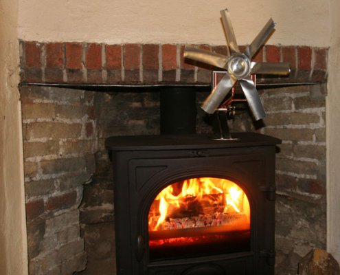

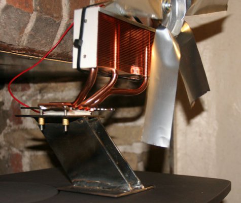

There is a Chinese copy on eBay, the originals are made in Canada.
Ingenious contraption, powered by a peltier.
http://en.wikipedia.org/wiki/Thermoelectric_effect
The temperature difference is created by the bottom of the peltier being heated through contact with the stove, while the top is cooled by the fins which act as a heatsink.

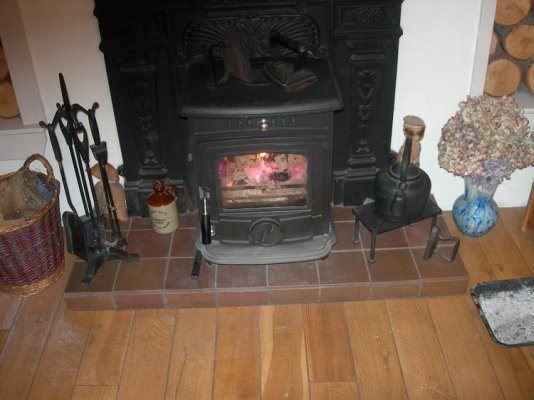

We have one. It worked well on our old stove, gave a good woosh of warm air and was worth having.
Then we replaced the old stove with a Clearview. Its top gets very hot, and on there the fan works too well. A veritable gale of air, so much so that it actually seems to blow cold.
So we moved it onto the Esse which, strangely, emits very little heat through the top such that the fan takes about an hour to get going and then delivers no more than a lethargic waft. So in the end for us it turned out to be an expensive gimmick.
But they can be good on some stoves.
