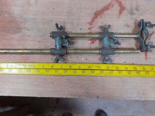

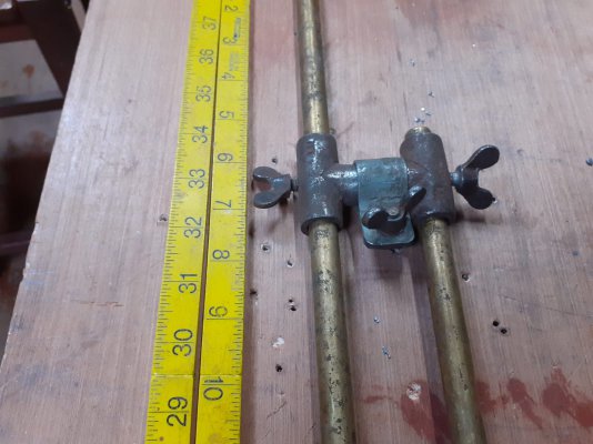

The Whatsits from long ago are Lead Dot Moulds. They were used to make fixings in lead sheet and other uses say for lead brackets. They are for both horizontal and vertical use...
Sorry for the delay in replying...i've had to master resizing pictures on a tablet.

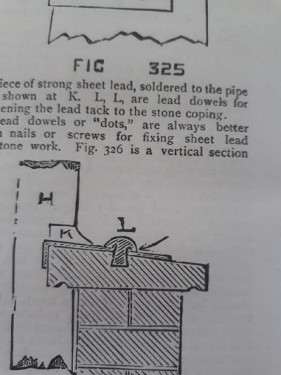

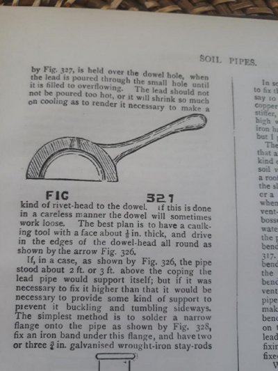

The pictures show the mould used to fix a soil pipe bracket. No battery drills back then...
