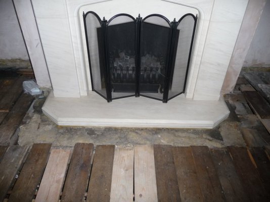

Well it's been a while, but feel the need to post an update. I have had a difficult time of it, been let down by builders, been ill and two years on still in the same position, but some things to report. The condition of my floor and hearth are exactly the same. Let's face it there has been plenty of time for everything to dry out. I keep an eye on humidity. I have dehumidifiers, windows open as much as possible. I bought Peter Ward's new book but didn't contact him, I just thought I'd monitor everything myself. I have learnt that the dewpoint plays a part measuring moisture too. Bur that's not all I've learnt.
Next week I am hoping for a builder to begin work on the floor and section of constructional hearth. The floor will be lifted and all debris cleared to assist ventilation. This might throw up undiscovered issues with the floor, but at the moment the plan is to replace any floorborads where necessary, treat or replace any dodgy joists, insert any damp proof membranes where necessary. As for the section of constructional hearth which sticks out beyond the stone fireplace, which I want to keep, the idea is to dig it out and replace with concrete, specifically they say:
Grind down and chip out area of old hearth that extends past the new hearth
Take old hearth down to a level to allow for 20 mm of airflow underneath the floor boards.
Does this sound about right?
I am having the chimney swept as well next week in preparation for a new gas fire. And electrics resited . Later some corrective plastering and decorating.
My main question is about the hearth. I attach a picture as a reminder.
Look forward to your thoughts.
