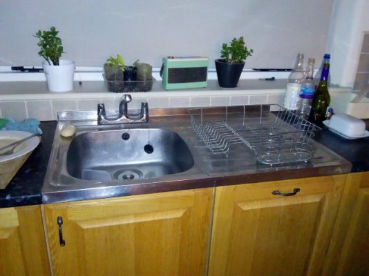

I'm stuck on the sink. They do flush mounted sinks these days which look smart, but I am concerned that someone (maybe even me) might want to replace the sink in 20 years time and if the exact size and shape isn't available then the whole work surface would need to be replaced to match the new sink. Everything else I've set up to cope with another 100 years of neglect so it doesn't feel right to set the kitchen up to need replacing every few years.
I don't like under-mounted sinks. I'm thinking it might be safer to go for over-mounted but everything else has turned out so slick and level it might be nice to match the sleek style. Any thoughts would be handy.

In my experience as a kitchen designer, no two sinks have exactly the same size and shape of cut out. With granite, replacing the sink is always going to be an issue.
In all honesty the Belfast is probably the most replaceable type of sink, though it's back breaking propensities are well known. There are stainless steel versions available.
If you are eschewing the Belfast (which I would) then there is the option of the undermount or overmount. The undermount with drainer grooves is significantly harder to replace.
With overmounts I don't think there is a lot to choose between flush mounted and classic. The shape of the hole is not significantly different. Though of course varies from one sink to the next.
Thanks, I'll aim for over-mounted rather than flush. I would hate to have some accident with the sink and need to replace it, then find I need to replace the work surface as well. I'll go for a stainless 1.5 bowl with drainer. The last decision before I start fitting cabinets will be where to put it!

Hello malcolm. Not been on here much recently but....... Sinks! On my mother's advice, I eschewed the insert sink and also the Belfast, in favour of the full-depth sink (what's the proper name for it?) I had to get one second hand as they're not sold in DIY stores, but I have to say, it's so practical. You can slosh water all the way around the taps, wipe it all the way from the back to the front, and I don't know how replaceable it would be if it needed changing, but more so than an insert one.
