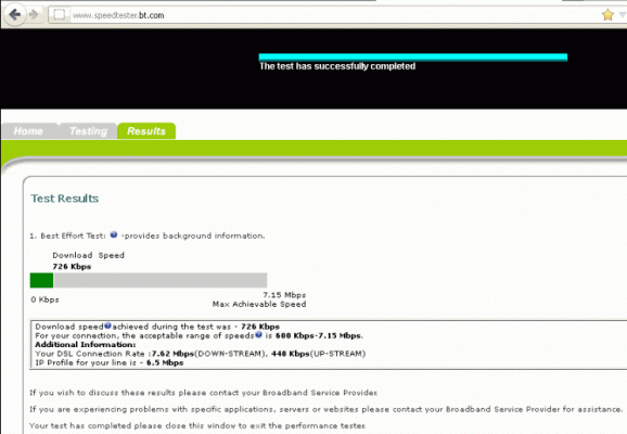

Yup, exactly the same as what I get. Please do try the BT test in my previous post and post the results on here. The output is gives is much more detailed than any other speed test I have seen, and it also saves the results straight to BT so they can't pretend it didn't happen!robgil said:it hesitates before starting to dowload the page, this hesitation can vary from a second or two to quite a while.
The BT tester is useful as it removes your ISP from the loop. As like Rob, your sync speeds are good, your house wiring and the connection to the exchange is fine. As the BT tester has removed your ISP from the loop, it isn't their problem. The issue is between the exchange and the exchanges connection to your ISP which is purely down to BT. As you have found, this can be difficult to get sorted.Me! said:I believe the DSL connection rate figures are what BT check (and remeber you are still with BT for this even though you go via talk talk) when they "test your line and it is all fine". However, as you can see, my download speed is anything but fine, my upload is even worse, and I suspect yours will be similar.
