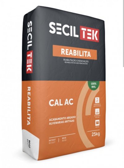

could that something be isovit ecork? Seems to have got a fair number of ecork and this stuff left over, so if i can use it all the better
That's pretty much my experience too. Great for sticking wood fibre onto walls. I do think it would be ok for dubbing out a brick or stone wall and maybe using it as a bit of a scratch coat for the Reabilita so stick to.In my experience, Isovit ecork is rather sticky - good for plastering over wood fibre and cork insulation boards and for sticking them to the wall, but otherwise a bit of a pain. Tends to stick to the trowel and it's harder to get flat than a regular lime plasters and mortars. I wouldn't use it on a brick or stone wall for that reason - too much of a pain and no need for the extra stickiness. However, if it were free, I might be happy to give it a go.
