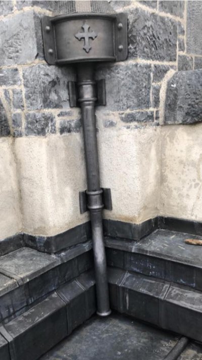

Flyfisher said:Fantastic lead work Doug!
I propose you start a separate topic where you can post your current (indeed, past) projects. They really are works of art.
Any seconders?

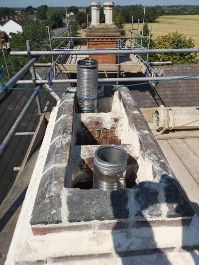

Feltwell said:...had a HETAS engineer out today, between us we smoke tested the one flue that I want to reinstate an open fire too, good news is that it's sound and no need to line it - so that's about £1k saved (liners for use with coal are more expensive than for woodburners apparently - and it's a *very* tall house).
Feltwell said:In times of yore they would have had lots of nice hot flue gases going up them in the colder & wetter months, which must have helped. Nowadays most flues are redundant and those that are in use are often lined, which must cut the drying effectiveness down.
overlander matt said:I'm also interested about insulation for flue liners. I've not insulated flues in previous houses which have had wood burners and wondered whether this is appropriate in a period property.

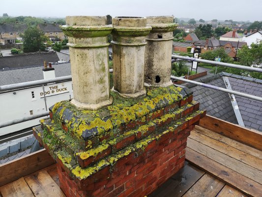

overlander matt said:At last the scaffold has reached the first chimney and we've been able to take a look at the state of it...
On the pots front, one has got a couple of good size holes which will need to be repaired. The holes are north facing strangely enough - I would have expected greater weathering from the west but perhaps they have been turned in the past.
overlander matt said:There does not appear to be too much mortar holding them on and decent gaps around each pot. There's not much (any!) mortar lining within the chimney either which I'm surprised about. When I've removed chimney stacks in the past there has been plenty of mortar lining the flues. Is this just a matter of this being a tall stack outside the building?
Feltwell said:Would a buff pepperpot chimney cowl not do the job for the unused flues Matt? They're not fixed in place, just sit there under their own weight.
