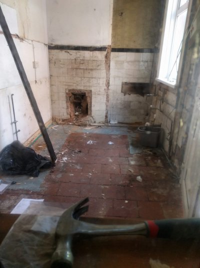

Westholme said:Soil of a crumbling texture doesn't sound like damp soil to me.
(Pardon, my lack of knowledge). But, Is it normal for the ground to be like that?
Thanks.
Dot99 said:Westholme said:Soil of a crumbling texture doesn't sound like damp soil to me.
Thanks.
Dot99 said:Kitchen is above the ground level.
Todays decision the tiles are coming out. Kitchen rather small so the floor is not overly visible. (I personally wouldn't walk on it bare foot). Also I imagine it to be cold to walk on in the winter.
Yes solid floors of any sort are cold to the touch unless the are heated directly.88v8 said:Don't skip them. 8" quarries aren't that easy to find.
Yes, tiled floors are cold, I never do understand why people put down new tiles.
But then, that's what slippers are for.
Ivor
Feltwell said:Dot, that floor looks identical to my original, untouched 1899-ish kitchen floor - in fact I'd offer a modest amount of money that "Dennis Ruabon" is written on the back of those tiles....
Give the floor a scrub with nothing more than mild detergent & water, then give it some time to settle down (and I mean at least a few weeks) would be my advice before doing anything. Honestly, you've got a lovely original floor there - the patina and wear is something you'll never get back, even laying reclaimed items.
Mine is also close grouted and on what is probably original cement onto earth, and is as dry as a bone - and I think it looks really nice & in keeping with the house. Pictures can be provided if you want!

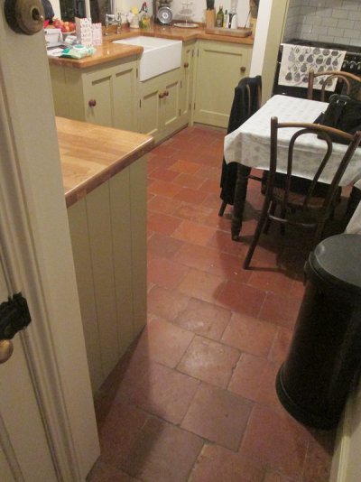

Feltwell said:Blunt opinion I freely admit, but I think you'd be mad to take those tiles up - they are perfect for a rented property.
Quarry tiles are as tough as old boots - they've survived for over 100 years already, they'll easily survive tenants. We've been here 10 years, the kitchen has had three young kids charging about in it, for about 2 years we regularly had sit&ride toy cars whizzing through the kitchen drifting - yes, they could get up enough speed to do that! - round the corner of our units - and the floor doesn't have an extra mark on it. It looks it's age, yes, but that fits with the house. At some point in the future you'll come to sell that place, many buyers will really value original features.
Here's mine - it's highly onerous care regime consists of waving a mop at it occasionally with a bit of flash in the water. That's it.

Pennyviz said:Those tiles look great feltwell - how did you seal them? Penny
