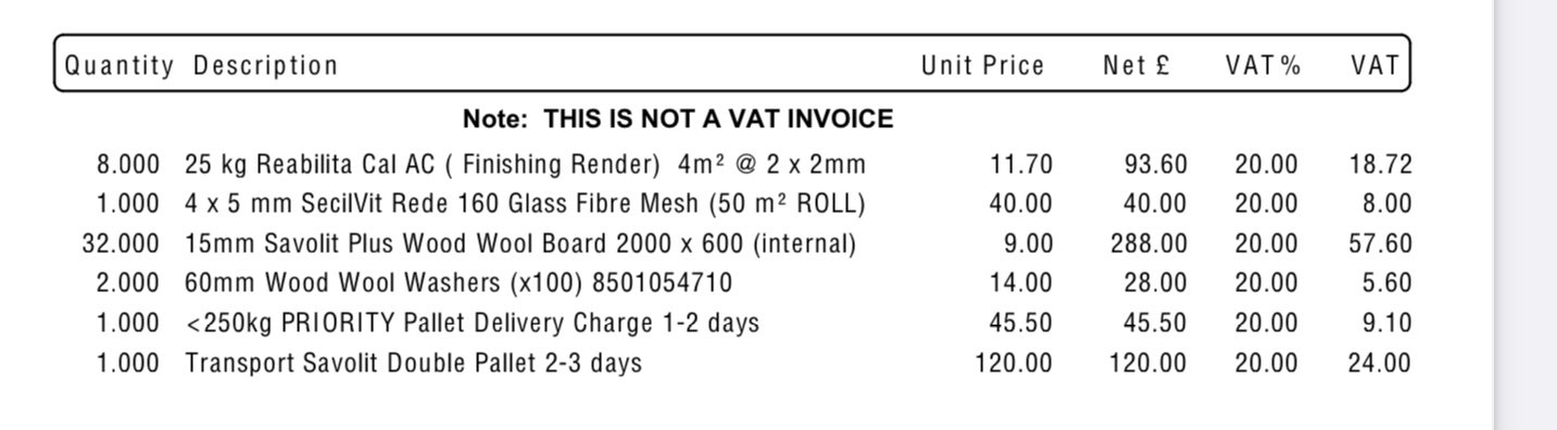

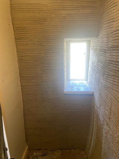

Would you mind sharing the total square meterage & cost? Trying to get a idea of what the professionals charge for this sort of thing...Just for future reference in case anyone else finds this thread - here is a snip of my 2019 Mike Wye quote from when I did my living room
We are currently getting about 50m2 of lime plastering done.Would you mind sharing the total square meterage & cost? Trying to get a idea of what the professionals charge for this sort of thing...
Was a while ago but scratching the memory banks, that did around 35 square metres, that quote was all my materials.Would you mind sharing the total square meterage & cost? Trying to get a idea of what the professionals charge for this sort of thing...

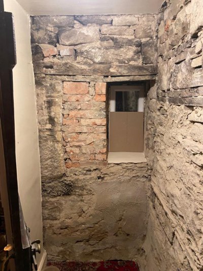

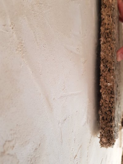

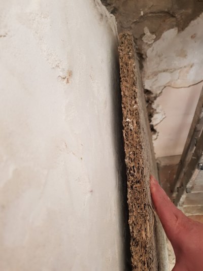

Yes, there are a number of breathable plaster adhesives that you can apply to the back of the boards before positioning on the wall. Here's some:Finally got round to having a whirl at wood fibre boards (Child number 2 halted play). I've basically filled the holes in the walls with plaster, it's not straight.
When I come to stick the boards on, I've got big gaps, see from images, so is there such thing as lime based adhesive, or just plaster it till level? I don't want to force the boards flat and drill in, as they may pull out over time. What has people done in such situations?
Also what length screws did people use to attach to wall, most say only need 25mm in the wall, which doesn't sound alot to me.
