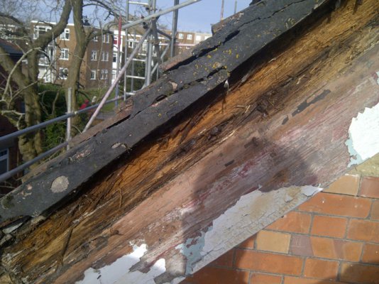

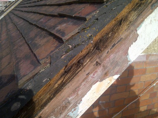

Zebra said:I see. In which case I probably agree with Feltwell that a fibre undercloak would do. It's thin enough not to raise the line of the tiles, and if you're not too concerned with historical accuracy in this location, then the fact that it's a single strip rather than individual tiles will probably offer more support to the verge, structurally.
Would the fibre undercloak be visible? How far does it extend to the tile edge?
