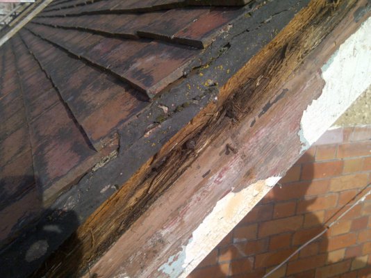

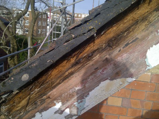

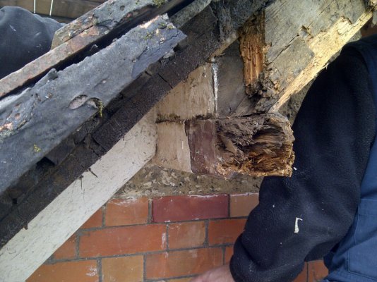

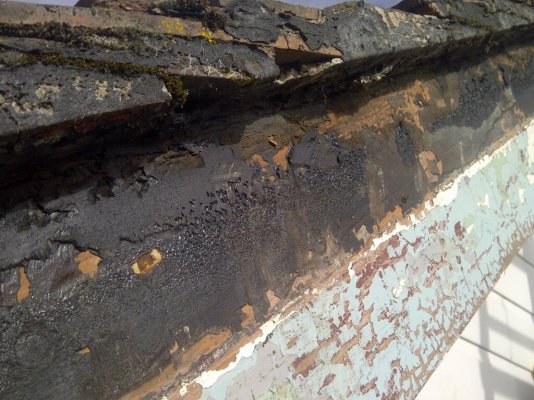

Hi All,

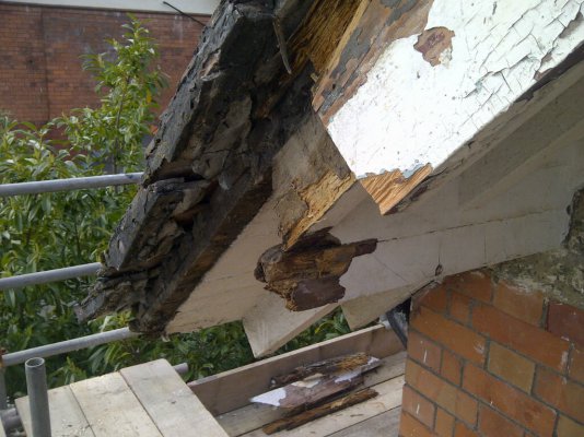

The sun is shining at last and our joiners have started work on the roof line. Just 5 minutes in and they have raised a question. How should this roof verge be treated?

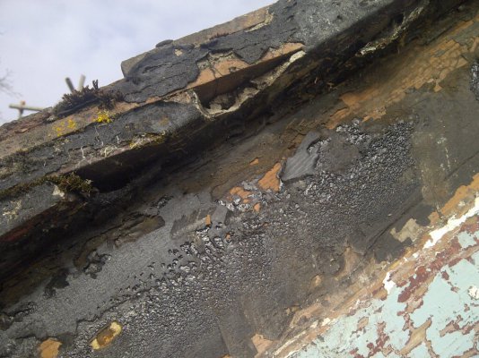

Water has been penetrating the verge and will likely continue to do so in the absence of weather protection on the exposed edge. The good news is that we're using linseed oil paint, which should help wick dampness away.
But, should we be treating the tile edge (a black gloop was previously used....)? Our roofer will be coming onsite after the roof timbers have been repaired/reinstated. The joiners have suggested we install a fibre undercloak, in readiness for the roofer..
(Looking at the damp timber hitting the scaffold, I'm thinking perhaps uPVC isn't so bad after all...... :lol: )
Thanks in advance,
Paul
