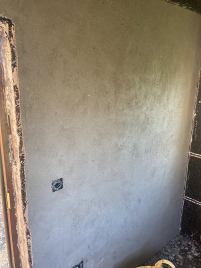

Depends on the contents - bigger aggregate will help reduce cracking on a thick pass. As will fibres/hair/hemp. If you chucked a thick coat of fine top coat on with very small aggregate, it will likely crack.Ok those are more the thicknesses I thought everyone was going to be quoting me. Are thicker coats more likely to crack than thinner coats?
