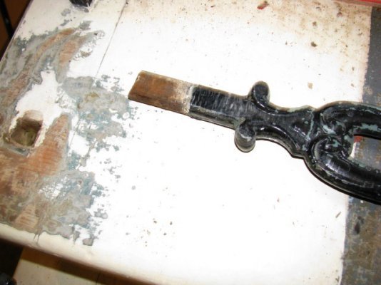

There is some movement in the newel which l want to sort out but l am not sure how the bottom of the newel was fixed, it will either been a spike that is nailed in or a thread mechanism. I don't think it will be a thread as in 1860's threads were not common practise. However it is impossible to get into the underneath. I was thinking of chiselling out some wood around the newel and filling with epoxy resin to make the joint stronger. Anyone have any other ideas?

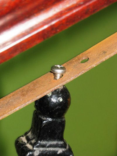

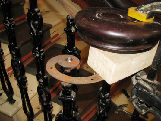

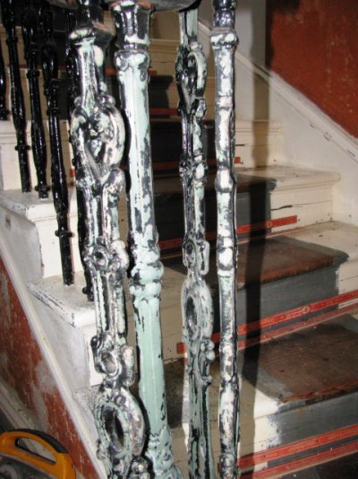

There is a broken balistrails , it is broken where it fits to the mahogany hand rail, it is a bent pin that hooks into a metal plate that rebates into the handrail (see photo) l am trying to come up with ways to repair this without removing the whole hand rail as it is bound to get damaged if l do.

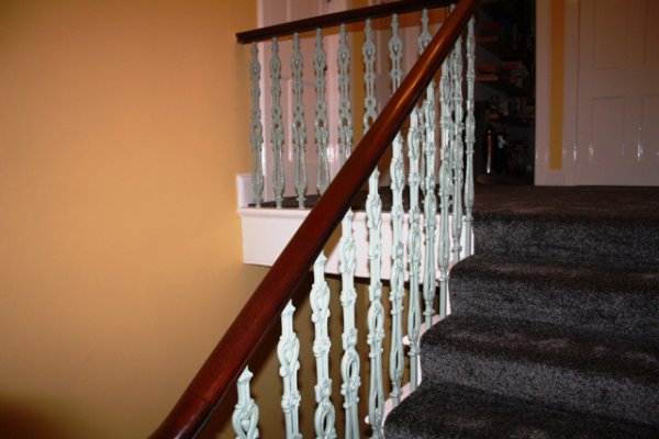

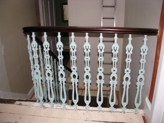

The first stair lift to half landing

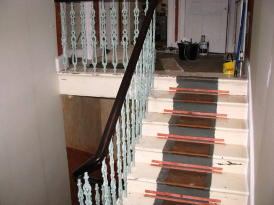

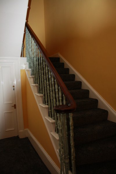

Newel

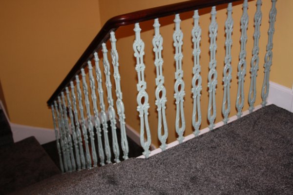

Newel into wooden bullnose step
3rd photo balistrails fixing into handrail

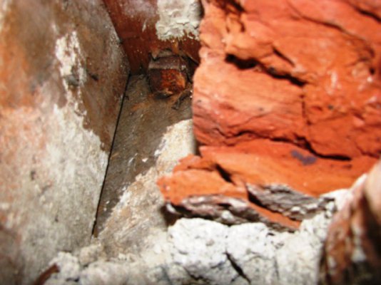

4th photo broken balistrails
