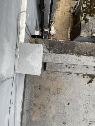

Wow Feltwell, that lead is really something! I don’t know why it’s hadn’t considered lead, or lack of it to be a possible issue on the porch roof previously. When built, I think these houses were quite high spec, and I guess at least some lead around the drain point of the flat roof, and possibly flashing where the roof met the house would be expected?? No such thing is currently there, and may well be part of the source of the issue. Hmm, I’ve got lead envy nowLike most sagas involving old houses, this one is neither quick nor cheap - the porch here at Feltwell Towers.

If you wanted to go "belt & braces", you could rebuild the roof structure with marine ply decking as I have and go down the leadwork route.
If what you've got at the moment appears to be secure, i.e. the joists are indeed bearing into the walls OK, you could do worse for now than just give it another coat of a waterproofing compound, over what's already there - with you having sorted the rainwater goods this could buy you some time, though of course it means you can't reinstate the ceiling inside, or you have to be prepared to trash it when you do come back to do the repair properly.
