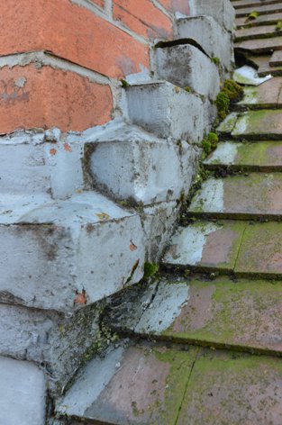

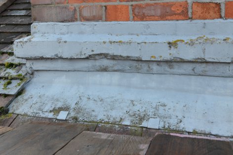

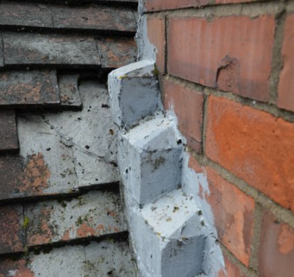

Zebra said:I can't help agreeing with Flyfisher, that those bricks, above the roofline, are always going to be a weak point in terms of water ingress, and it might be better to remove the protruding parts, and cover the whole joint with something reliably protective, like lead flashing. .

DJH said:A competent leadworker with welding and fabrication skills in excess of your average roofer will be needed...
Doug
It is often surprising just how much more the average roof worker knows about lead work when they realise YOU know all about it too.paulb33 said:DJH said:A competent leadworker with welding and fabrication skills in excess of your average roofer will be needed...
Doug
You guys are scaring me now… :shock:
Lime said:Unfortunately IME most lead roof workers will do as little as they can get away with.
