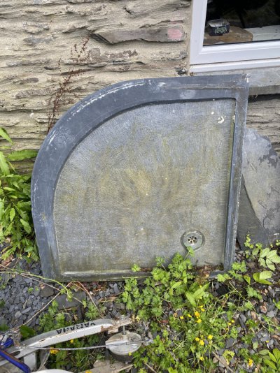

Nice timing, we are in the middle of our bathroom. Because we are having complete new bathroom suite, I've knocked everything off the walls (pretty much the same as every other room) had a nice collection of layers including wall paper
Turns out the small external portion of the wall had masonry paint on it too, that's gone. I feel it's almost therapeutic swinging a hammer round, until I realise I need to clean the mess up.
