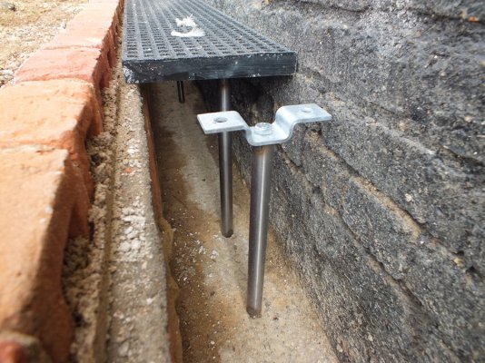

Hello stripy friend, long time no see….. ( says she who was missing in action for ages ).Aww thanks twig........malcolm also has a similar trench. What do you think malcolm, shall we patent it, the "Zebcolm trench"?
I think Malbra rolls off the tongue betterAww thanks twig........malcolm also has a similar trench. What do you think malcolm, shall we patent it, the "Zebcolm trench"?
But we'll not be able to sponsor McLaren or Ferrari Formula 1 cars if we choose that name. For me it's very much the Zebra Trench. Especially when you have a nice stripy grating to finish it off. I had been trying to work out a way of lowering all the exterior ground level by 18 inches but a trench beside the wall was a far better solution. It has worked very well and I'm very thankful for the idea.I think Malbra rolls off the tongue better
I'll need may need to dig some trenches soon, both external and internal. Is this the 'Zebcolm' trench being discussed? And where can I purchase those natty metal supports and grills, can someone link me the thread please? CheersI got the idea from you. The fibreglass grating looks really good. Nobody has told me off for not investing in cast iron.
Thanks MalcolmA search for Fibregrid on here should pull up the information about the grating. It is normally supplied in huge big sheets but Fibregrid will cut it to the width you need. Though it seems to have become green in colour now https://www.fibregrid.com/search-results/?ap-q=square mesh grating
I used a short retaining wall to mount one side of the grating and fabricated some stainless supports because I was worried about water settling on top of support built into the wall. I don't think that would have been much of a problem in hindsight. The galvanised part is a "21mm Top Hat U bracket" that can be found on Google. Zebra's supports were probably more sensible.
