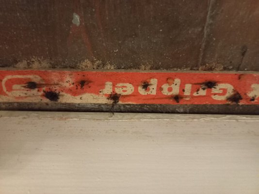

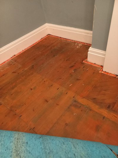

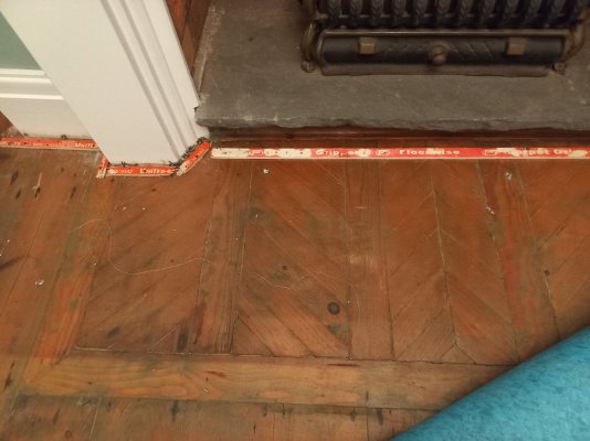

Thought you might be interested in what I found: decorative floorboard patterns near fireplace and rusted metal in the carpet grippers, suggesting the carpet is holding moisture. I'll pull it up this week for the sake of ventilation.Floors are quite tricky in my opinion. Like you I plan to go utilise the original floorboards because I can't envisage another practical option. My house certainly smelt damp at the beginning. The previous occupant, Ruby, had carpet down everywhere and I'm convinced that was where the smell was coming from. I'm sure a lot most of the moisture in my house rises up from the sub floor which can get damp after prolonged periods of rain. Ruby's carpet had simply become damp.

Looks pretty good, I'd make use of that original floor for sure.Thought you might be interested in what I found: decorative floorboard patterns near fireplace and rusted metal in the carpet grippers, suggesting the carpet is holding moisture. I'll pull it up this week for the sake of ventilation.

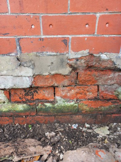

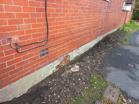

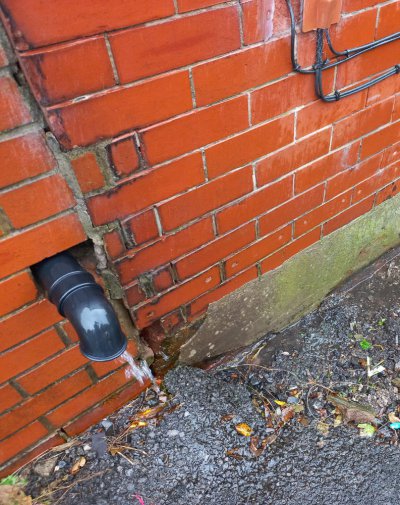

And satisfying to know you're doing what's best for the house.I've been busy. Once I'd cleared the weeds at the side of the house and cleared the soil away from the disintegrating cement plinth, it was easy to see how the water flowing from the down pipe onto the side road (no gully) was pooling at the bottom of the wall at the front corner. So I've run the down pipe inside the garden wall to discharge at the end of the path. Future jobs I'm probably looking at: removing the rest of the plinth, repointing, French drain? Possibly a new plinth as four courses of bricks looked damaged but lime.
Have also cleared the blocked airbrick of what looked like cement and cleaned the rest. By shining a torch into the gaps I think I can see into the subfloor through each one. I'm going to check below the decking at the back as there might be blocked airbricks below the patio doors. It doesn't make sense to me that there are some at the front and side but not back, as surely it's best for air to flow from front to back?
