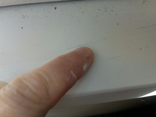

Zebra said:Hmmm. So I did a test windowcill in Bedec MSP a month ago, to see how it would hold up compared to the Linseed Oil Paint. It is south facing, in a sheltered location, in full sun, in the South East of England, in summer.......but it's cracked already. Only a hairline in one place, where it always used to crack, I guess there's a fault in the timber there. Have I done something wrong in my preparation?

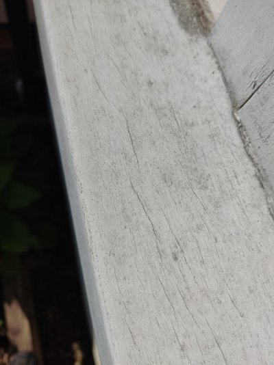

Yes, this sounds very much like the issue. Interesting. Is the underlying linseed remnant in the crack not stable, then?Me! said:any cracks in the wood of the sills, even hairline ones, seem to have linseed paint still in them and cause all future coats of water based Jotun to crack along the same line. Jotun do warn that painting over old linseed paint can cause problems.
Does this sound like the problem you are seeing?
