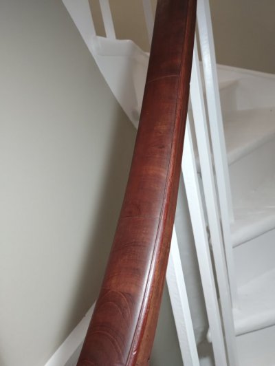

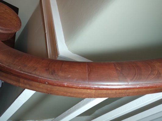

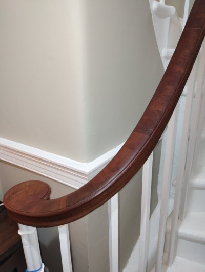

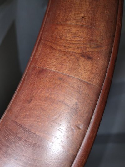

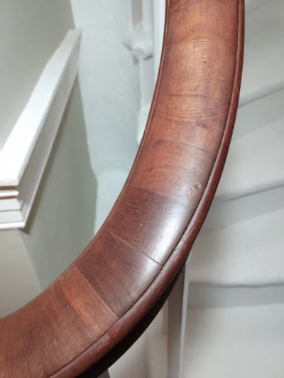

I did take some time today to try rubbing some meths on a less visible spot, and the brown coating was coming off on the rag. I had read that Meths dissolves Shellac but not other coatings, and I thought this might help identify whether the coating was Shellac or something else. It started to come off a bit on to the rag with the Meths, so I went at the bottom end of the banister and the pics below are after. The grain of the wood is a bit more visible now and it does seem that the wood on the veneered caps is nicer than the wood that the rest of the railing is made of.
