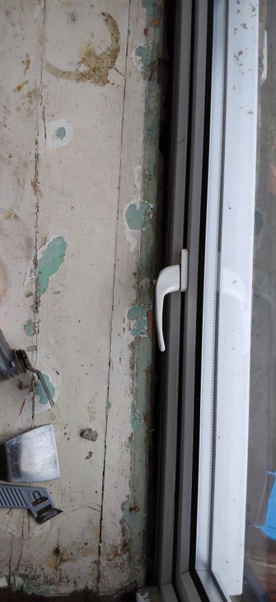

Ah so this is at the bottom of the window and on the interior side? Are you going to be putting any new sill / window board on top of that existing wooden sill surface?Difficult to show. . Gap is about 3cm
What do I fill gaps and cracks with
if it’s getting covered over that’s the type of void that I usually pack with sheepswool coated in clay / lime slip.Yes. Repair that and put something on top.
