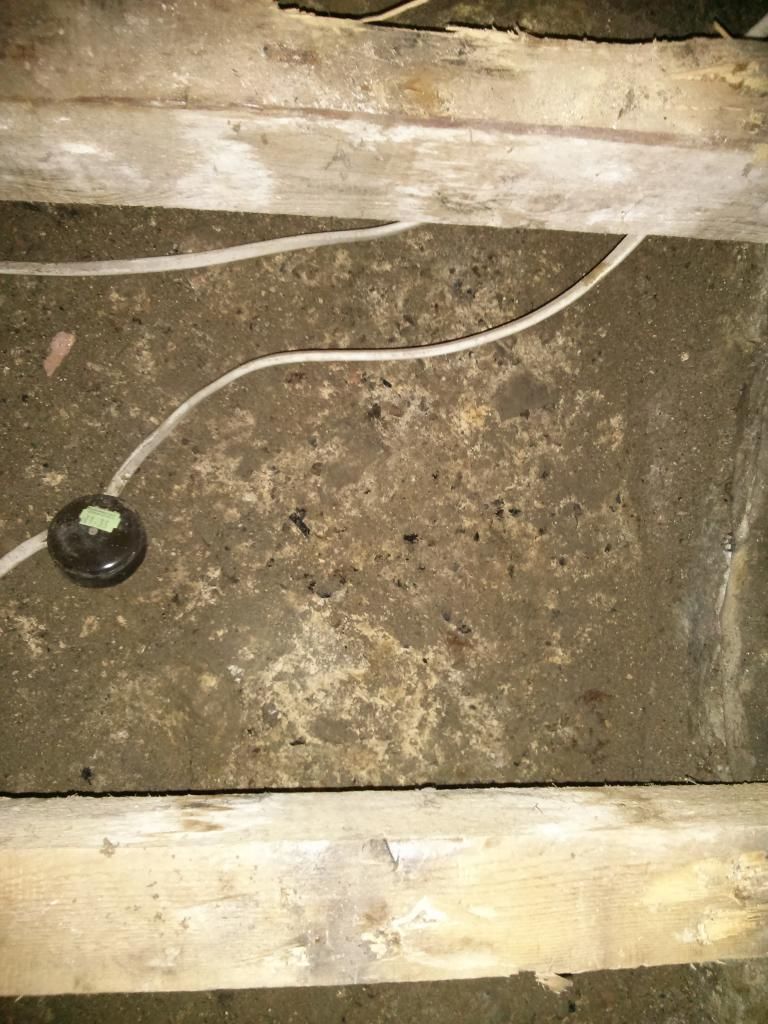

It has a suspended wooden floor apart from the kitchen which is solid and looks original (large 'red' flags/tiles). The soil under the suspended wooden floor is fairly close to the joists (maximum 20cm, touching the joists in some areas) and is damp clay and rubble (no standing water). Where the soil touches joists and wall plates, they are rotten. There is a smell of damp especially in the front hallway - especially noticeable when the house has been closed up empty, and a big problem with slugs.....

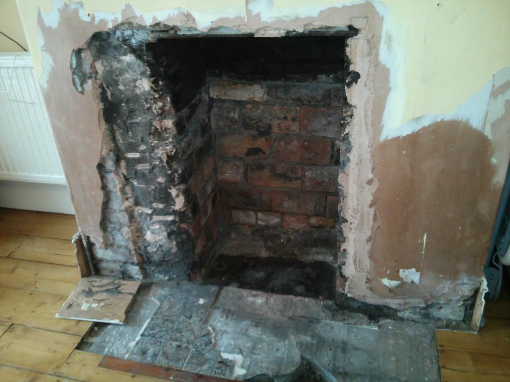

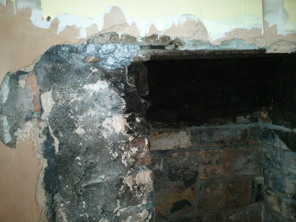

The limiting factor seems to be the rear where there will be only one airbrick in a very sheltered spot between fence and conservatory. Therefore my planned solution was to break up the hearth in the rear dining room (we've removed the repro fireplace) install a vent in the floor at the back of the hearth and a conduit through down into the subfloor. I was hoping the draw of the chimney would help ventilate.
