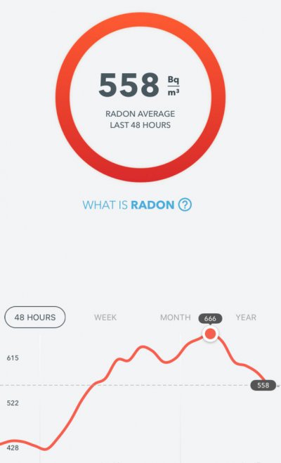

As @a twig points out my air volume is indeed c200m3. Think four square rooms with a central hallway; no direct "line of flow" bit enough space I think to be able to draw air sufficiently. I am still curious if the artificial air flow creates any sense of noticeable 'draught' in your setup...That's a large space to ventilate. The key is to experiment in terms of what system is required. To get decent air quality for use as habitable space you want 4-6 air turn overs per hour. Assuming your basement is 2m high thats 400 m^3 of air so you likely need extraction rates at least around 1200 m^3 per hour. I use Tornado dmevs but none of them would give close to that. I would imagine some in-line fan designs might deliver that. It also depends on your set up down there. If there are things like 90 degree turns then you may need fans on internal walls between rooms to help ventilate the air through the space better.
With a large space like that I would personally install some more air bricks - the larger the better (https://www.castironairbricks.co.uk/). I think standard single air bricks would be too small to ventilate that space. Put some high extraction rate fans in the back and see what sort of air quality that gives.
