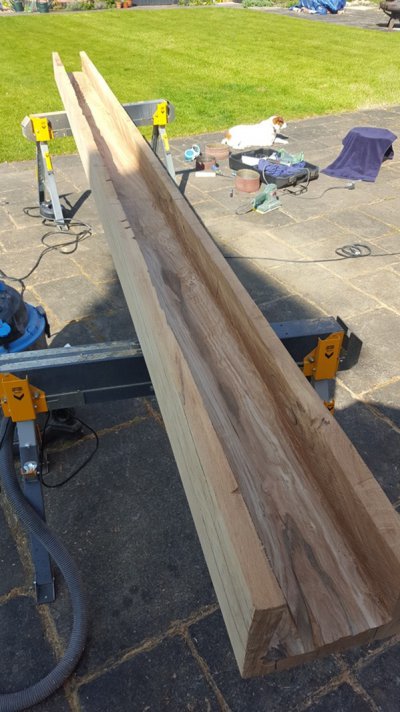

steveb said:re the fire rating, I would try a layer of fireproof plasterboard between the steel and the beam - get that signed off and then add the beam as a decorative coating. Have you got a hollowed out beam approved as 30 minute fire break? I know that in practice it will be fine but interesting experiment if a BCO will put his signature to it as I doubt that it has a certification stamp on it, so it's his neck on the line rather than buck passing to some 3rd party agency*.

*I had a great BCO who let me use hand-made oak ledge and braced doors with a clear intumescent coating as equivalent to fire doors but I have the suspicion that lots of BCOs wouldn't do that
The BCO is fine with my proposal ie 50mm thick all round offering nearly 100 minutes of charring resistance. Oak has clearly defined fire resistance, approx 0.5mm/min, so if thickness is sufficient no need for any certification and nobodys
neck on any line.
