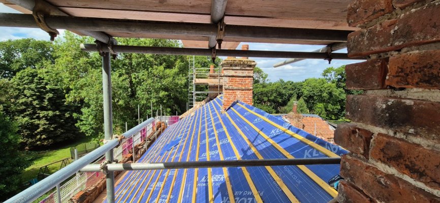

Water coming down the walls internally because of roof problems, so very very keen to get going...listed consent seems to be ok and dont need planning permission...
But...BATS. not obvious we have any but must be likely (there have been bats in the past and a few flying around, though not as many as 10 years ago sadly). And its pretty much too late to get a bat survey. so technically it may mean waiting till may, with all the additional damage that will come with that.
Cant decide whether to risk it - ie build in some sensible mitigations to the works and cross fingers none are found (or if they are that the builders are willing to carry on). has anyone ever had builders find bats, and how did they respond? don't want to have them down tools and incur costs while getting a license if the worst comes to the worst. but not sure I'll be even able to get the work done next year if I need a survey in may, the license, then start and have to complete by sept.
