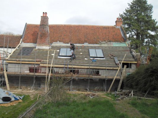

plasticpigeon said:That sounds excellent. I would have done the same. Even when it is more effort to restore I usually end up doing it because I hate throwing stuff away, especially if good quality and historic. It would be nice to see photos of your house now with all the extra windows.
plasticpigeon said:That looks great!
