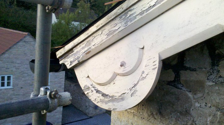

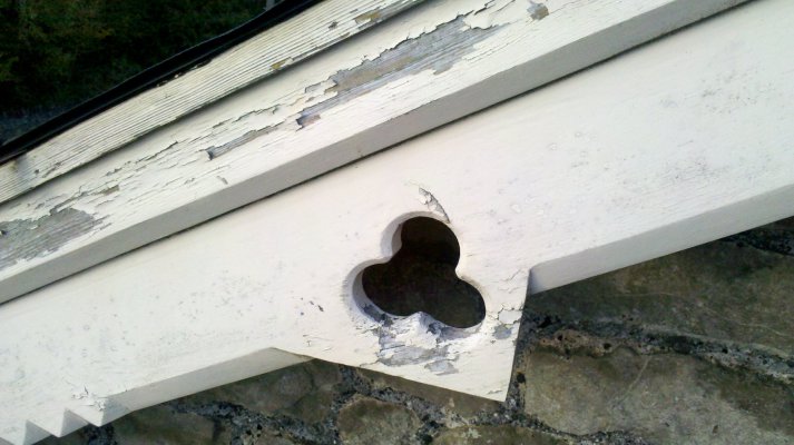

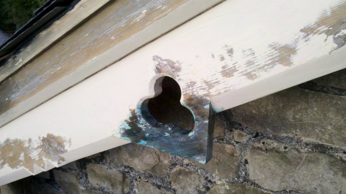

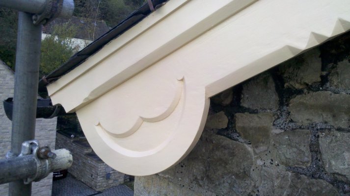

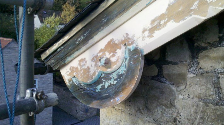

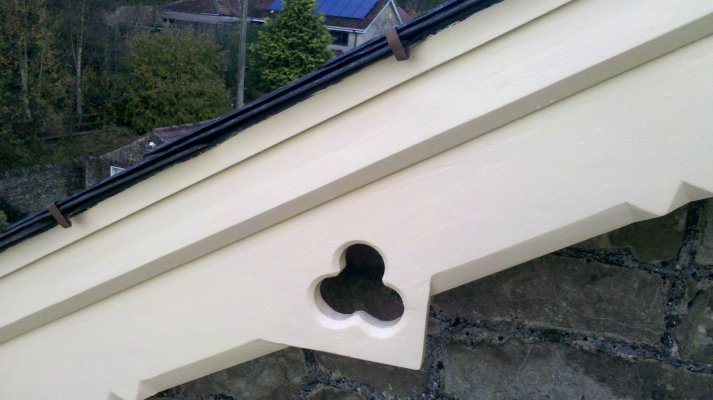

Thank you, if barge boards can be cool, those are. Because of the shake one of those trefoil bits was a scarfed in 'repair' from new. I've replaced two including that one, and all the ones on the south west elevation now have a long brass screw up through them to hold them together. The same barge board design is on the other end of the house, but it's like new since it doesn't get strong sun or the prevailing weather. For the sanding disk I'd say flat surfaces, they're extremely effective, with care leaving a beautiful finish on the bare wood. Definitely not something to be used anywhere near glass!Hmm, thanks for the tip re the Norton paint stripping wheel. I am losing the gumption to continue stripping my windows, though I will persist. A revelatory tool tip might be just what I need. Is it okay on fiddly bits, or just flat surfaces?
Barge boards look fab!
