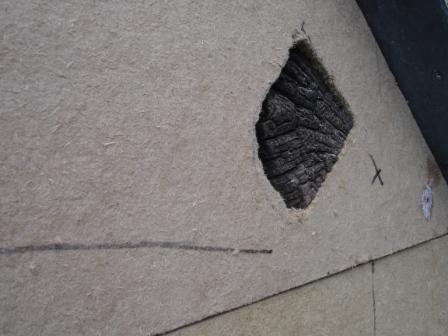

Have a puzzle which I would be glad if you would turn your grey matter to!
Where the beam ends originally protruded through the original lime plaster, and now I have applied external wall insulation onto the frame, these beam ends still protrude, though not very far. I could perhaps leave them exposed and cut in the render around them, and seal the joint with frame sealant, though with the risk that if water gets down between the beam and the insulation it will rot the insulation from the inside. Option 2 is render straight over them, though there is the risk that differential expansion will cause the render to crack at this point. Option 3 is to make little lead hats to cover them, tucked in between the beam and the render at the top, but running out over the render underneath, though with the drawback that this won't allow the beam ends to breathe.

Some types are parrafin impregnated. Some are not so must be used with a water resistant layer such as a breathable membrane (ooh, that's just given me an idea for the beam ends.....).
