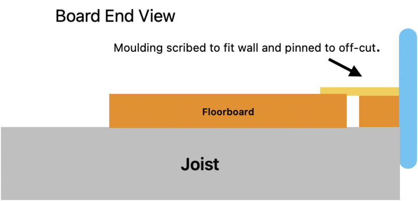

Thanks for this mate, the floorboards are already laid (we did that a couple years back now). But your diagram solution is definitely an interesting option and seems doable. My wife is handy with all the “scribing” stuff and I’m handy with the jigsaw. Do you have any pictures of that solution implemented? I assume the moulding should probably match the wood flooring as opposed to being painted?Come what may you're going to end up having to make a number of 'scribed' cuts on all the boards that meet the perimeter walls simply to get a reasonably close, <10mm, fit all round and careful planning of the board orientation and layout can be vitally important. I had the devils own job here when I was planning the new floors for the 'East Wing' because the rooms are trapezeoidal rather than square or rectangular and it was essential that I ensured there was enough 'meat' left on the boards that meet the perimeter walls to get a secure fix to the joists/sub-floor. You have to remember also that you must leave an expansion gap all round the perimeter to avoid buckling/rippling - the boards themselves will expand and contract as conditions in the house change.
It's this expansion gap that drives the need for a skirting board of some kind. Most of these are designed to be fixed to the walls and, in effect, they float above the floor unaffected by any expansion of the boards. However, such skirting does not play well with irregularly shaped walls such as yours and a different approach is needed. One of these, and the least attractive to my mind, is to accept the inevitable and fit the skirting to the wall as normal and then inject a filler behind it to fill the gaps. The far better approach in my book is based on using a thin, circa 5mm but at most 10mm, moulding laid flat on its back and scribed/cut to meet the walls profile and fixed above an off-cut of the flooring timber which is not connected to the main floorboards around the perimeter - the expansion gap is left between the off-cut and the floorboards. The diagram below may help to explain better. Note - noggins may be needed between the joists to provide a base for the off-cut on the reciprocal wall.

With the floor already down that kinda precludes my offering - you'd have to lift all the boards touching the perimeter walls to cut them to accommodate the cut-off and expansion gap. That may be easy enough beside the length of the floor planks but a real bugger with the ends of the boards. You might consider then using the adhesive employed when fitting engineered boards to solid floors to fix the moulding to the floor edges rather than nailing them. It's reasonably flexible and strong but can be cleaned off the back and board surface if it ever parts company with the floorboards.Thanks for this mate, the floorboards are already laid (we did that a couple years back now). But your diagram solution is definitely an interesting option and seems doable. My wife is handy with all the “scribing” stuff and I’m handy with the jigsaw. Do you have any pictures of that solution implemented? I assume the moulding should probably match the wood flooring as opposed to being painted?

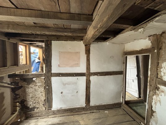

Gorgeous fireplace!I can’t help too much - all my floors were added to the barn about 400 and a bit years ago. As they didn’t chose to use the rails to pick up the floor joists as a plate and disturbing the infill, instead pegging bearers onto said rails, for the joists. I suppose it means that I effectively have skirting as part of the original timber frame and floor boards don’t meet line timber panel infills… the internal historic partition was built with a lower plate over the existing boards, so again avoided this challenge! Maybe there was method to their madness…
