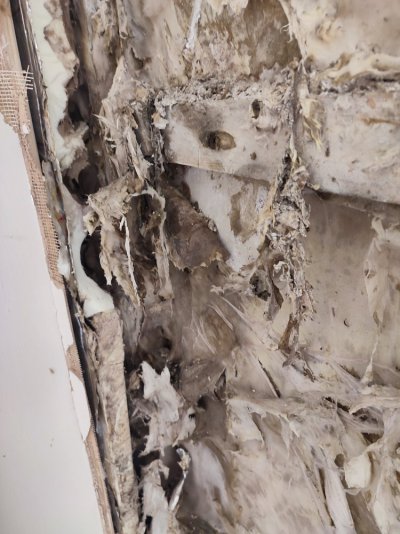

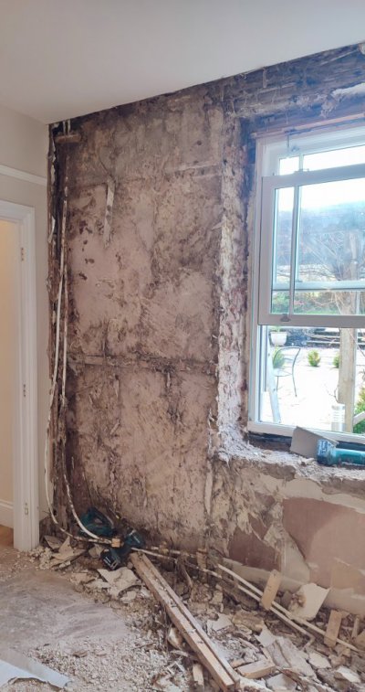

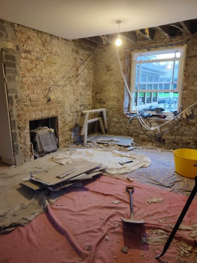

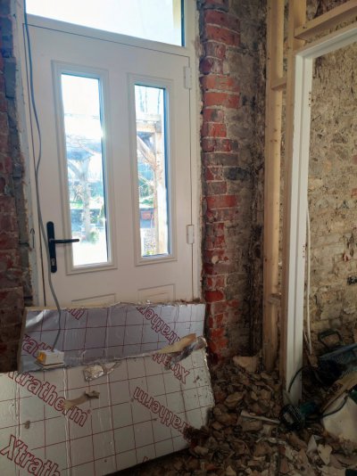

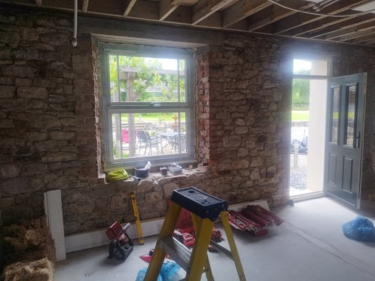

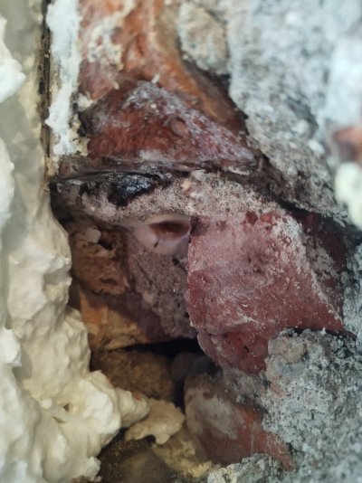

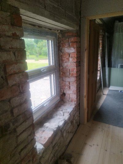

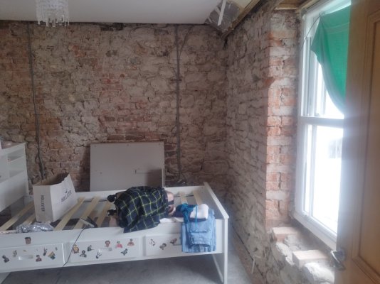

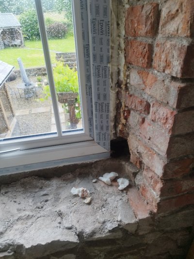

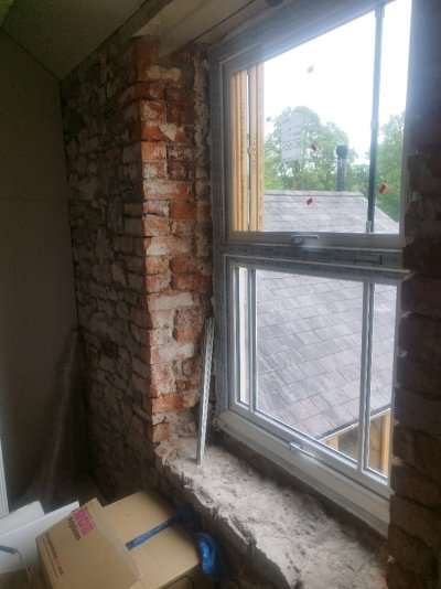

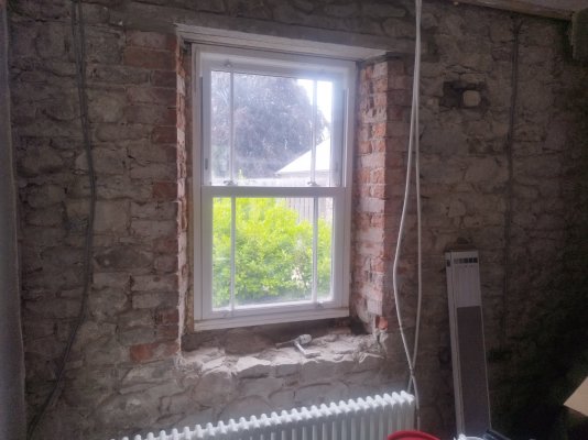

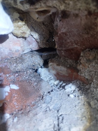

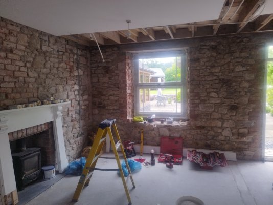

Do you know at what point the house was renovated?So we had an independent survey, problems are condensation due to the celotex stud wall void, penetrating damp due to hairline cracks sand/cement external render, and possibly a drainage issue exacerbating a wet ground floor. All the problems on the elevation that gets the weather. Internally have been recommended to remove all the stud celotex and also the original internal plaster which also appears to be a cement type render and get back to the stone wall, which I can see does have lime mortar. If money were no object then I would be stripping off the render externally and internally and going back to lime. However, the finances will currently only stretch so far, so my question is, once we have stripped down internally, treated and removed the visible rot, resolved fresh water ingress and replaced damaged timbers where necessary and then left to dry out...if I did just lime internally would that help until such time in the future we can afford to re render outside? At the moment we might just have to repair the cracked sand and cement render externally until we can afford to replace....would this approach at least be a step in the right direction amd allow the wall to at least breathe is one direction? Many thanks, oh and this is the rot in the upstairs, see attached pic ..
Could there have been a leak from that radiator which had not completely dried out?
