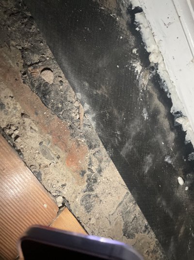

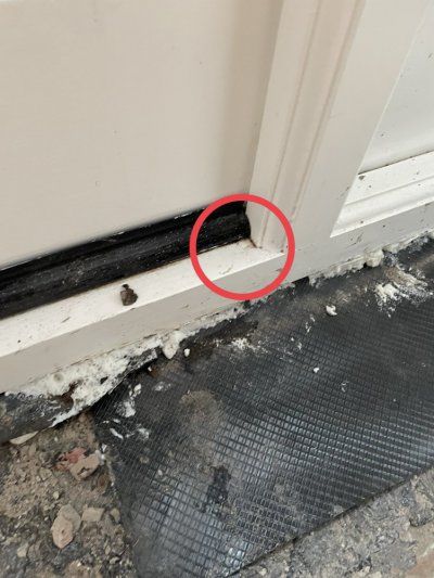

They were recommended, provided case studies and seemed competent. The other areas of the frame seem fine so far.
The gap between frame and DPM is only pressured with mortar being forced in underneath the membrane. Why would the expanding foam be injected between frame and DPM, would it not be better to go underneath the DPC so the DPC is tight to the frame rather than foam to the frame, or is it a case of the DPM should be forced tighter to the surface below it rather than above?
You would be temped to get rid of the DPC altogether?
