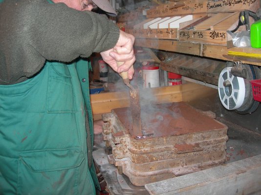

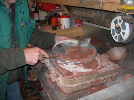

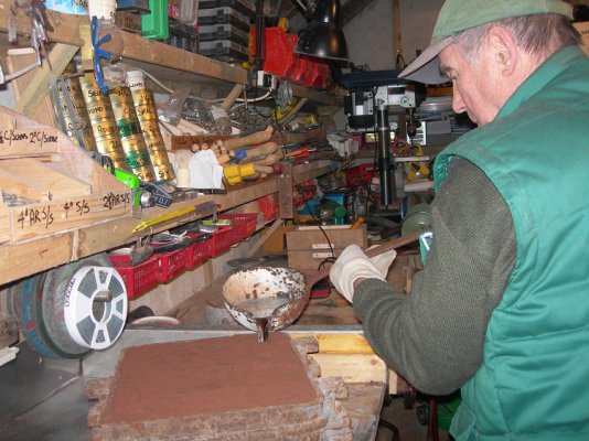

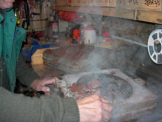

DJH said:.... here's the warning bit. Lead is a very heavy metal and even the smallest piece belies itself with it's weight, so care must be taken when lifting it and wear gloves as much as possible although, as I said before lead, in it's natural sate isn't absorbed through the skin but by ingesting it so no lead sandwiches then!!

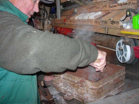

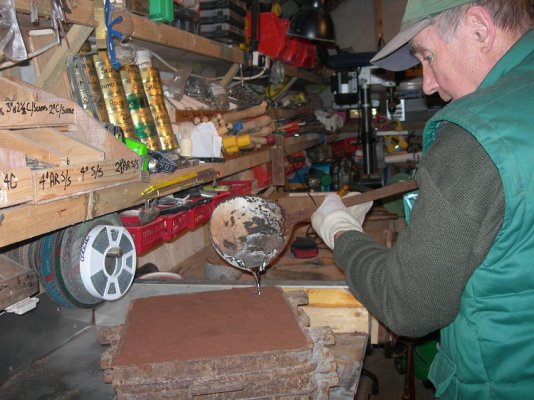

I've melted the lead in the pot slowly without overheating it. Working temperature is between 350 and 400 degrees. If you have a pyrometer then well and good but I poke a DRY bit of wood into the melt for a second and when it's withdrawn it should be honey coloured. Again, this is one of the methods I use but I'm sure there are different and safer ways of doing all this.
I always warm any ladles I use before put them into the melt. In that way you don't get any flying bits of molten lead flying around the place as any moisture on the ladles will cause a mini explosion. A ladle full of molten lead is very heavy so a bit of strength and care is necessary.
