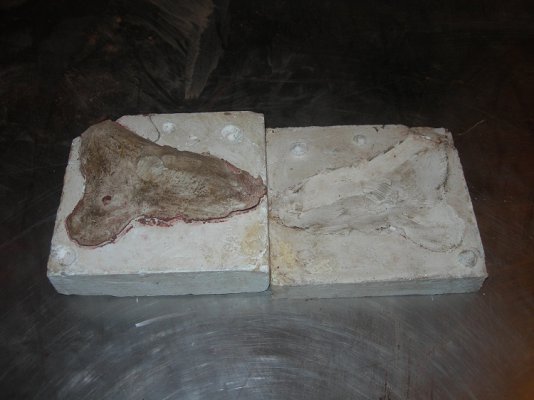

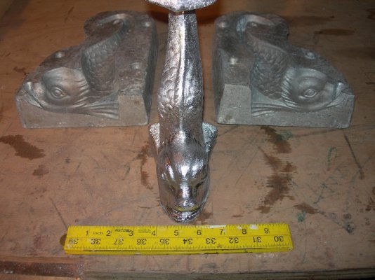

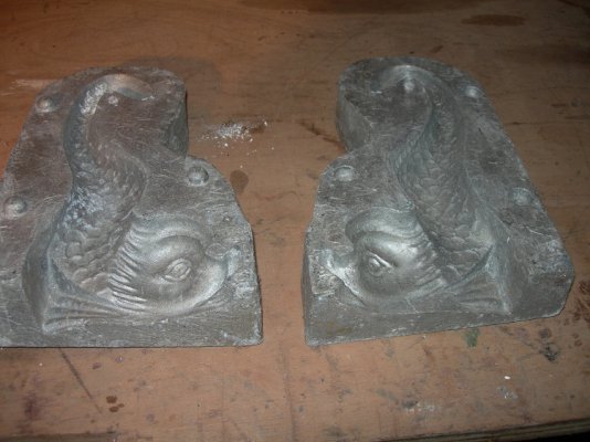

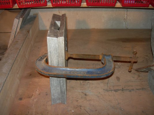

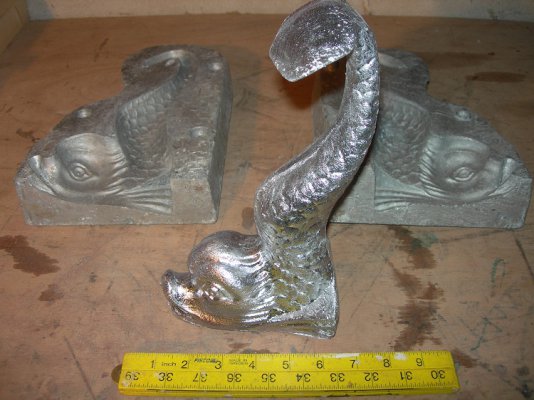

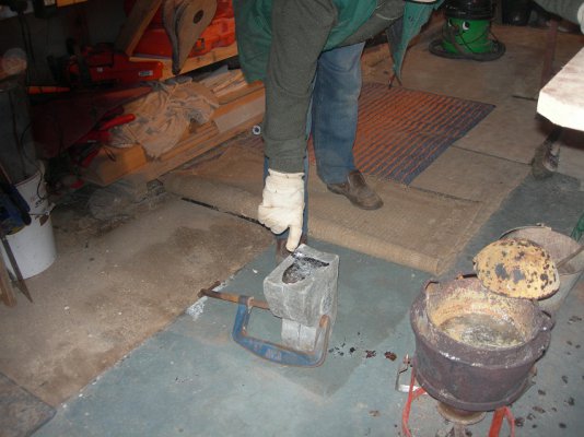

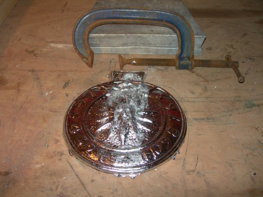

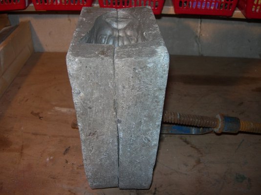

D DJH Member Messages 1,532 Location Co Tipperary Ireland Dec 24, 2012 #21 I still have a few chills or dies hanging about and this one is of a small dolphin fishy thing.... held together with a clamp filled with molten lead and I'm waiting for the contraction rings to start forming..........

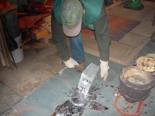

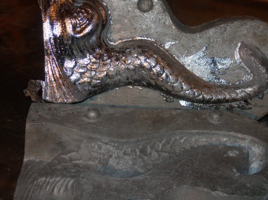

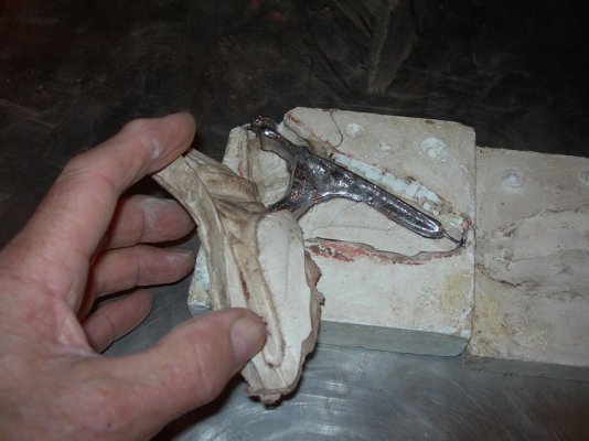

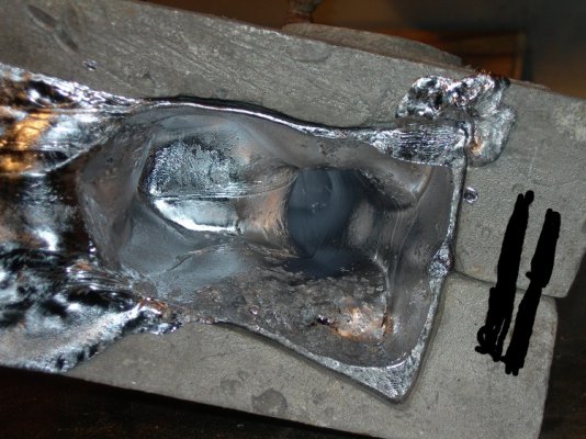

D DJH Member Messages 1,532 Location Co Tipperary Ireland Dec 24, 2012 #22 Tipped over and 'slushed 'out......Mrs DJH is outside the door taking pictures, something to do with toe nail polish or something :lol: this is a view up inside the casting. The wall thickness is about an eight of an inch thick at the bottom. It will be thicker at the tail

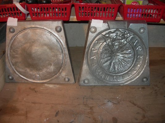

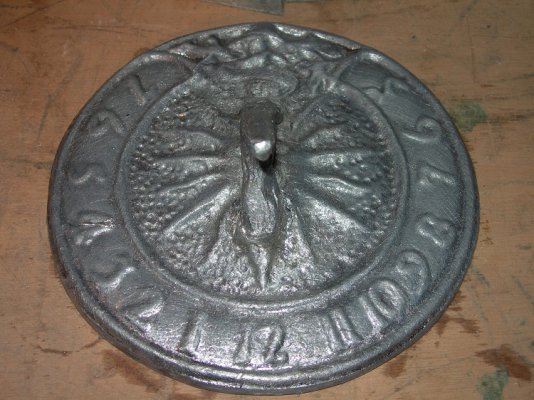

D DJH Member Messages 1,532 Location Co Tipperary Ireland Dec 24, 2012 #24 At the same time I cast a sundial and gnomen.......

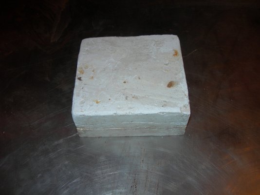

D DJH Member Messages 1,532 Location Co Tipperary Ireland Dec 24, 2012 #25 I've cast the gnomen in a rubber mould with a plaster case as I recall i didn't have time to cast an aluminium chill for it at the time.
D DJH Member Messages 1,532 Location Co Tipperary Ireland Dec 24, 2012 #26 The finished job with the gnomen soldered on and it's had it's dunk in a bucket of rainwater. PS It's set for Summer time. :lol: Doug
