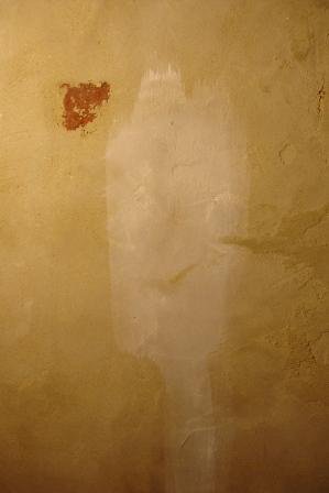

I used limewash on this house almost two years ago and it is still fine with no colour coming off. However, I applied it over Mike Wye's Regency plaster which gave a very smooth finish, with either 3 (as recommended) or even just 2 coats of limewash (where I've been lazy); also, the limewash covered a much greater area than advertised. I very much doubt whether limewash will do much to smooth or "seal" your rough surface as it is very thin. Moreover, I would guess that the roughness will make it more difficult to apply (which I found VERY easy). I suggest you try an area using a test pot and see.Zebra said:... I decided that a sponged finish was what my house would be getting!
It looks great so far, but once dry the sand in it does rub off when you touch it. I haven't applied any limewash yet, but will limewashing solve that problem?
Thanks to Robgil for the detailed post in this thread about how to apply limewash. How many coats might be needed to "seal" a plastered wall in this way?
Park Henry in front of it and they can have a staring contest...Zebra said:I seem to have drawn a weird face in it which is looking at me......
worms said:Claim it as a miracle and open the house to pilgrims! That should pay for the renovations!
Uh-oh! Zebra's been at the cooking sherry again. :roll:Zebra said:I seem to have drawn a weird face in it which is looking at me......
