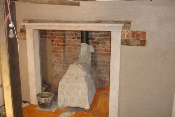

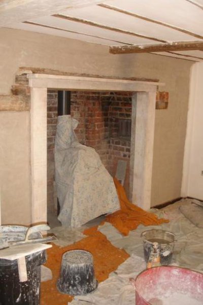

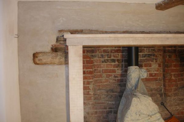

Zebra said:Those are both very good points malcolm, thank you. Indeed nothing is lost this way. Perhaps I could do the base coat like that, post a picture on here, and then decide before I do the top coat.
I've done the base coat leaving the ends of the beam exposed. Now that I've done it, I'm not sure it doesn't look daft. What do you all think? Please be honest.Zebra said:And what do you all think of the idea of plastering the wall but curving the edges of the plaster around to leave the ends of the beams exposed, so that you can see where the fireplace opening has been enlarged?
(cringes in expectation of a general gasp of horror/groan of exasperation from you all...)*
*But please dont' be shy of telling me if it's a bad idea. I have learned in my four years on this forum that my ideas are often wrong, and I'd rather get it right in the end than get my own way!
