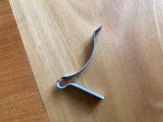

We have a selection of rim locks in our Edwardian semi and one has just stopped working. Opening it up shows that the steel spring has snapped - see photo. Any advice on replacing? We're keen not to cannibalise from other locks around the house if we can avoid it.

Amazon?
https://www.amazon.co.uk/Rim-Lock-Sprin ... 7860&psc=1
(I didn't think about amazon and have just been googling soft spring steel etc.. then Amazon came up.)

Richard, thank you! Didn't imagine anyone would make or sell such things!

loads on ebay too

I highly recommend this chap:-
https://www.ebay.co.uk/itm/144209559415
He'll have several listings. Very helpful, I've had 2 off him in the last year for different locks. Send him a picture of your old spring sat on graph or squared paper preferably
