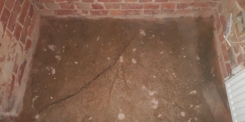

I decided, in the end, to remove my concrete over plasti fllor to replace with limecrete.
No major issues other than hard work, but under one area was a very dark line that is wet to touch.
Its like its a channel of water, but doesnt really go anywhere, and the soil each side is dry.
Im am a bit perplexed by it, and also unsure if i need to do something about, though quite what im also unsure.
Thoughts???

Just a thought, could it be the remains of a tree or vine root that has rotted away under the cement. The moisture is ground moisture collecting in the cavity. With cement over a plastic the moisture had no way of escaping so it rotted out the root, now that it is open the moisture is pooling.

+1 for Gothic.
Or perhaps a prehistoric mole tunnel.

The weird marks in the soil were in fact water ingress from outside. The foundations are lumps of limestone.
There was a significant gap. Either there was never any motar inbetween or it had long since decayed. Dug it all out and packed it with more lime mortar.
