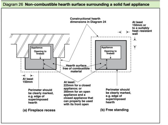

I am after advice once again, we are putting a couple of wood burning stoves into existing fireplaces and a couple of questions keeping coming up.
Do we need to get permission from the conservation officer and do we need a flue lining. The later our chimneys are extremely large with a fantastic drawn especially due to the size, the inside of the stacks look really quite good, so is a flue liner really needed?
