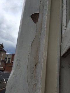

If there is some surface erosion but the stone is still doing its job structurally I would suggest you regard it as patina and leave it be. Is the paint perhaps trapping moisture in the stone and causing some delamination? If so, perhaps a poultice strip removal of any existing impermeable paint, and then repainting with something genuinely breathable.quad121 said:Hi i wonder if anyone can advise on what to do with the sandstone surrounding the windows as they are not very smooth?
quad121 said:When trying to apply the lime mortar tithe gap between the window and surround it falls out!
