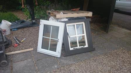

plasticpigeon said:The white one on the left of the top picture looks good, not sure about the others though :wink:

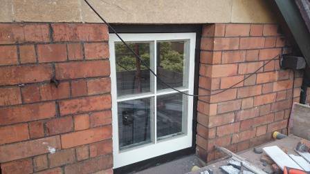

plasticpigeon said:I see you've gone for horns on the frames. Very traditional. How were they fitted? Thet really do look superb. I have puzzled over fitting sashes, first one just wedged in by the horns which was as originally constructed but I wouldn't repeat that, it's not a good solution. Next one I skew screwed through the linings into wooden wedges in the wall, the holes being covered by architrave. This is a method copied from an old joinery book, it seems solid but I think metal brackets would have been better still.
