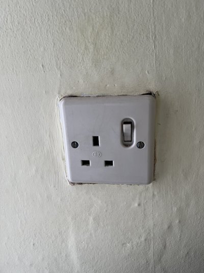

One slight fly in the ointment - The screws will be (I believe) 4BA, whilst modern ones will be M3.5. You either need to reuse the old screws or run a tap through the old fixing holes. Trying to force modern screws in to vintage holes will just bugger up both threads.Should take your leccie all of 90 seconds to change it - so don't bother putting the kettle on.
