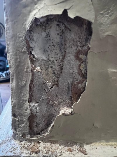

if you look at the pics i'm not hacking all that cement back to brick. Just going to chip off the gypsum (pink mortar).It'll probably be about an inch thick when hacked back to the blockwork. A 2kg tub is more for really small patches. You can get a 25kg bag of hydrated lime for around £20, and make a tub of lime putty with the rest for future use. It will keep for years with a bit of water on top.
I'd guess you need about 10kg of plaster.
