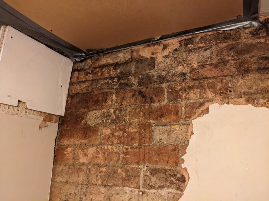

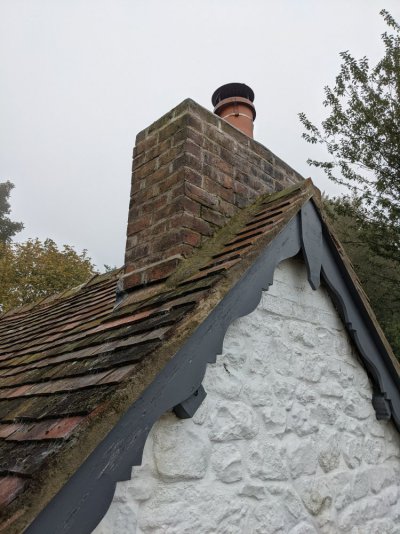

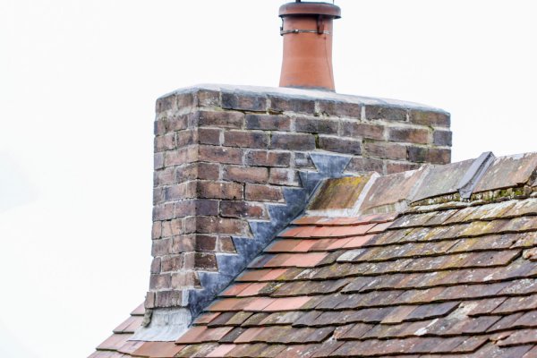

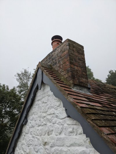

But this post is about the Chimney. I noticed some mould and wet walls in the bedroom around the chimney breast a while back. Wanting to strip back and refurbish the upstairs, I didn’t think twice about hacking a load of plaster off the walls to see what the problem was.

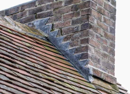

Found wet walls. Obviously had been like this for quite a while, but the inch thick gypsum plaster was probably doing a decent job of hiding it. But it didn’t really dry out and shortly after that, during some heavy rainstorms, I found water running down the walls. Long story short - the leadwork around the chimney was shot. The chimney cap was also found to essentially consist of a couple of slabs and some sand.

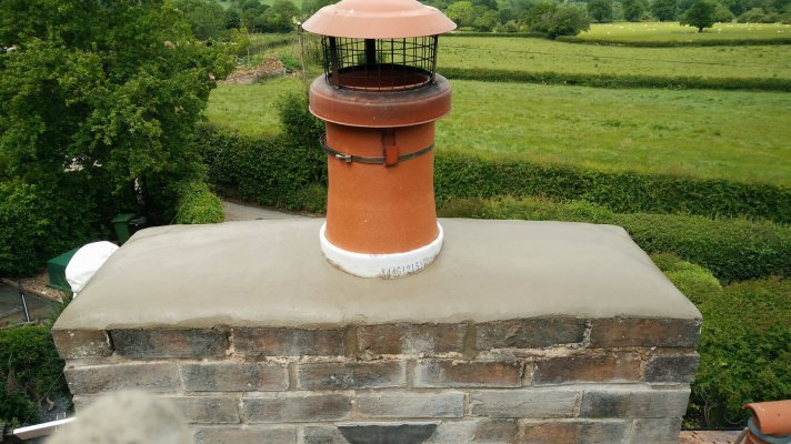

So replaced the lead and the cap, replaced the pot, and tried a little bit of repointing.
Still had some water running down the Chimney face inside the roof/bedroom. Checked and the leadwork looked fine, but maybe I messed up. In frustration I added some lead sealer/mastic stuff in any gaps or joins. Sealed any cracks, gaps in cement cap. And have recently painted the exposed brickwork with Stormdry.

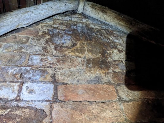

Now I don’t get running water down the chimney breast internally. But the bricks on the breast and in the bedroom are still damp. I can run a dehumidifier that drys their faces out, but few days later and they have gone dark and look and feel damp again. The plasterboard on the ceiling will also be damp.
Any suggestions or thoughts about what or where the problem is? Are the bricks just shot? Are they just absorbing the rain water and its soaking through further down the chimney?
This is where my current thoughts are sitting. Is that a thing? What would a possible solution to this be? - rebuild the chimney with new bricks? Take down and add DPC above the roof line and build stack back on top?
Or could it be something else?
I’m at the point where I’m tempted to try anything to find the source of the issue. Even considering wrapping the chimney in plastic / clingfilm see if that reduces the damp… haha
Fire place probably was a traditional fire for much of the stone cottage life. But has had a log burner installed, with flue all the way to the top, with some form of insulation beads around the outside (maybe, unsure it was like that when moved in)
Thanks for any help, comments, suggestions, critics, etc etc. Just want to figure this out as its been a problem for a while.

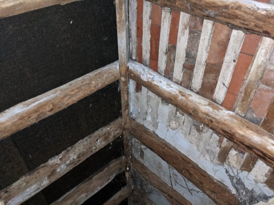

Attached a bunch of images. Mostly of how it is currently. The one side of the roof was redone (probably when someone added a conservatory) as it has felt, but the other has the original lime plaster directly on the back of the tiles. This lime isn't present next to the chimney, as I had to remove it to remove the tiles to sort the leadwork out. I need to poke my head up in a storm to see if any water is coming up under the tiles, but I don't think this is likely the source as as mentioned the damp seems to be coming out of the bricks, rather than down their faces.
