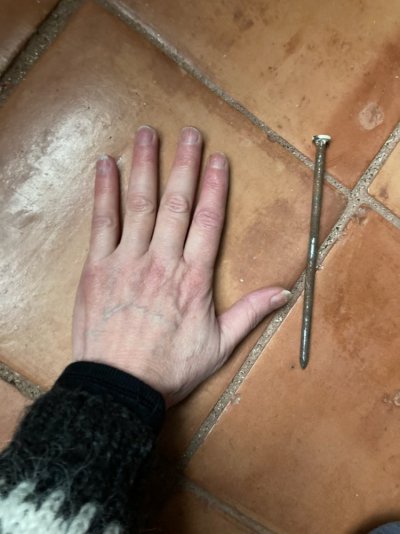

My lovely electrician told me this yesterday-new builds have a life-expectancy of 25-30 years. I was speechless! What about the waste? The carbon footprint?? Where are people going to live??Well, that explains the 6 inch nail fixing. But thankfully they missed everything of any substance - clearly the rawlplugs they were using didn't work so they resorted to brute measures.

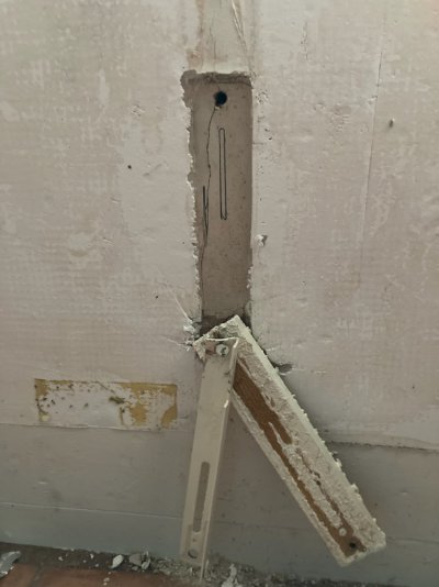

These old places are always cans of worms and worse still every time you kick over another stone you'll likely find lots of little nasty wriggly things roaming around. In your shoes my longer term plans would include getting rid of the concrete render - the frame needs to breathe out not in. Are the beams and posts exposed indoors? When was the external render applied? Why was it done? Is there any evidence of damp/water ingress near the joints or peg exit holes indoors?
For now you can make the fixing points of the boiler and radiators sound by injecting a suitable material in to each of the holes using a pressure gun. This will fill up the cavities to allow a stronger and more reliable fixing point Assuming that the new boiler and radiator supports have mounting brackets that have a different fixing pattern it would be wise to do the same when drilling new holes to ensure the new rawlplugs can get a good anchor.
