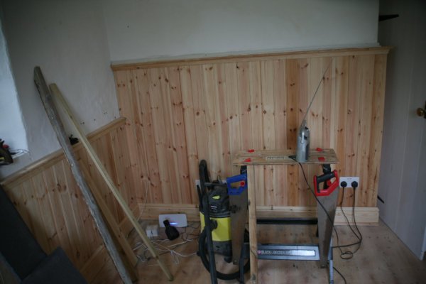

I have installed laboriously wainscotting in the ground floor of my old cottage - and put 15 mm polystyrene insulation behind it. I haven't vented it - and reading the forum see that I should have! the horizontal battens are continuous so there must be very little air movement anywhere! Now there seems to be moisture on the walls rising about 15 cms above the level of the wainscotting above the level, Any thoughts of a cure - apart from ripping it all off ( noooo!) and starting all over again.
