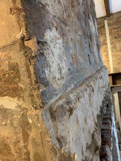

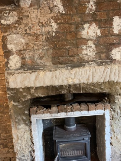

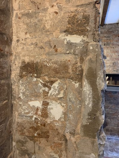

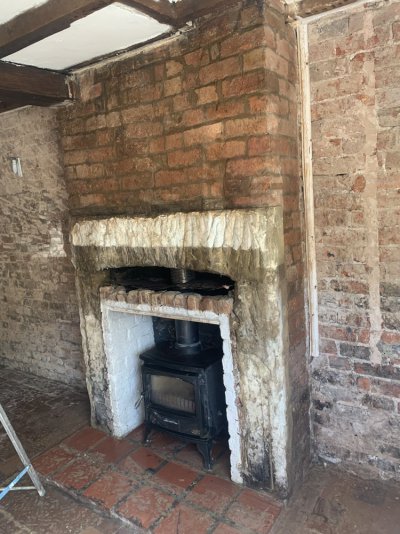

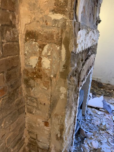

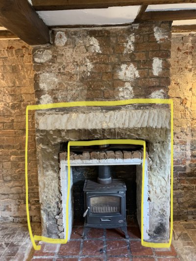

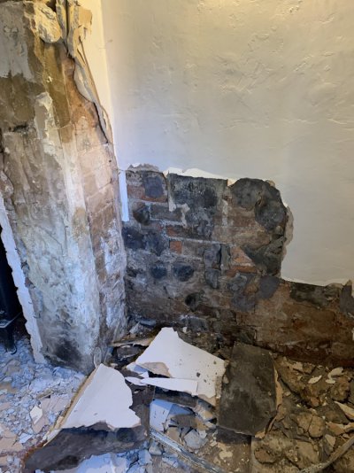

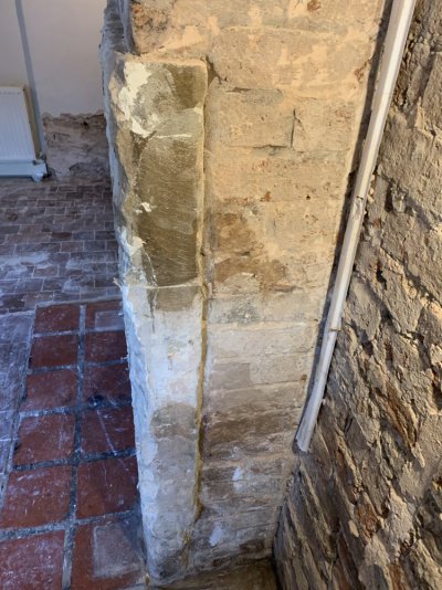

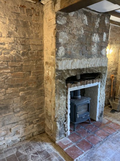

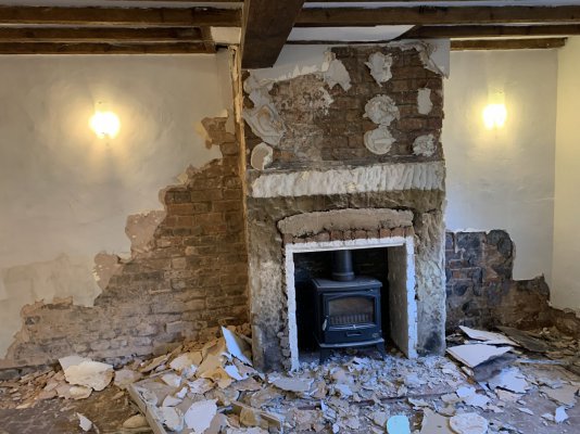

Thank you for the suggestion. Best means of cleaning the bricks? Harder stains to get off are the dot and dabs they usedI'd put a nice wooden surround up and clean the bricks above (and leave exposed)....

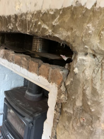

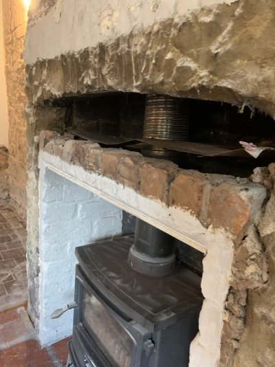

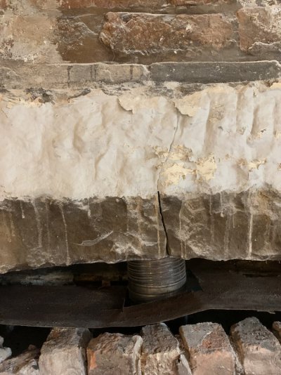

cutting stainless steel is never easy and getting a clean and reasonably accurate cut while the pipe is in situ and without dislodging it from its fixing at the top of the stack will be nigh on impossible.
A portable sheet metal nibbler or even a jig-saw with suitable blades could do it. The real issues are getting a reliable measurement and manoeuvring such tools in a confined space without disturbing/stressing or breaking the upper mounts of the flue.As an aside, I have surplus single skin stainless steel gas liner in my basement fireplace, will that be a problem to cut too? There's something close to 40' of liner hanging from that basement chimney pot so a fair old weight. We had surplus liner in the Breakfast Room fireplace too, and I don't recall the gas fitter having any problems trimming that to length.

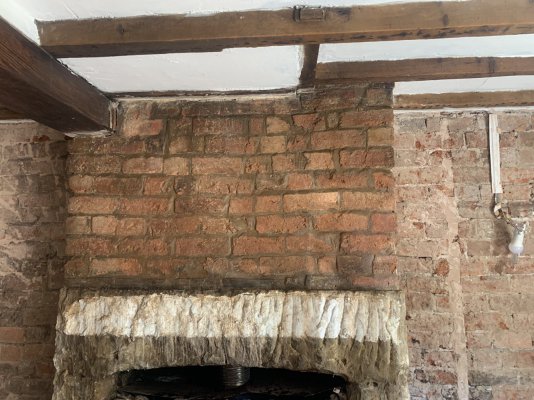

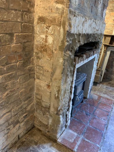

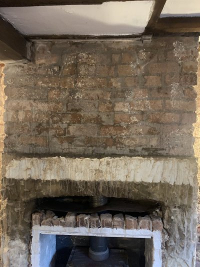

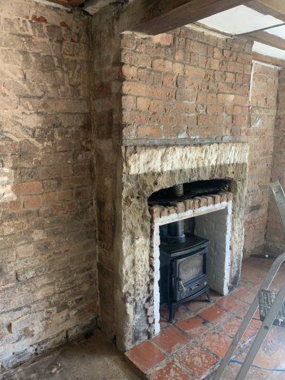

Would you recommend brick acid to clean the bricks? Or just some old fashioned sponge and some soapy water?Thank you for the suggestion. Best means of cleaning the bricks? Harder stains to get off are the dot and dabs they used
I cleaned with bristle brush with warm water and then used some gif. Spent about 2hours scrubbing. Any other recommendations as there’s still loads of plaster in the cracks of the brick
