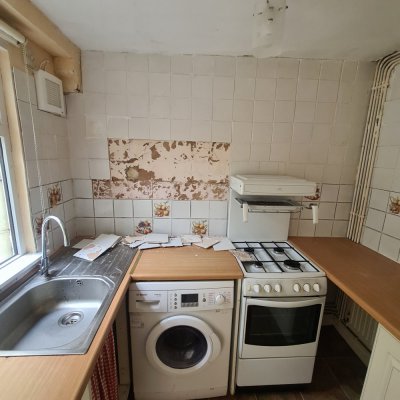

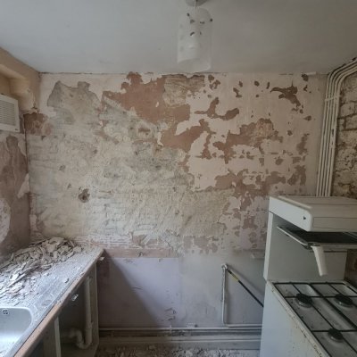

I have attached before and now photos showing the wall covered in tiles and my progress of taking it back.
My idea is to take it right back to the granite stone retaining wall and see how workable it is as it is. I am also aware that I may be better off tanking but i'd like to see how this goes first. A side note, there is an upstairs room which is the bathroom. It has a stud wall which is dry. There is a vent which when removed revealed plenty of draft airflow behind there and lose hanging sheet of plastic material, don't know what the wall is like on the other side, i guess i should have a look but haven't got that far yet, also not sure if i'll ruin what does not require fixing, but if its so wet on the wall below then perhaps it is part of the same issue.

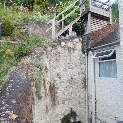

The retaining wall extends above the extension and has been cemented in, i assume this is stopping the wall from breathing maybe?
Around the footing of the property has all been cemented in and so i'll dig one of those French drains in too.

cemented at the top of that retaining wall
the inside ground floor

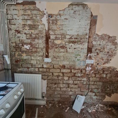

after removing some material, the tiles pulled off very easily from the damp wall, the lower part of the wall (not tiled) was not very damp.
Partition wall with neighbour was soaking wet, i guess ingress from the retaining wall, strange that it was all over though (compared to the main back wall which was not drenched below the tiles, however maybe down to it not having any damp proofing, there is a whole load of holes at the bottom of this wall which suggest some injection damproofing applied in the past)

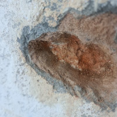

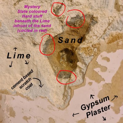

this is my own interpretation of the layers that have been used to cover the internal side of the retaining wall, the hole in the middle is the granite stone.
